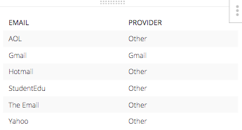

And, the else statement would be ‘Other’ for every other email address provider. The resulting table of this CASE STATEMENT with corresponding emails alone. Would look like this:
Email and provider table

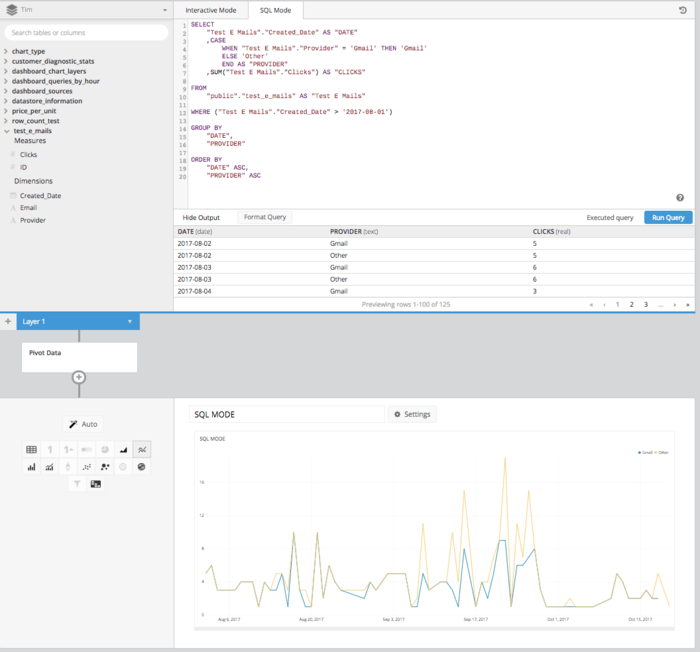

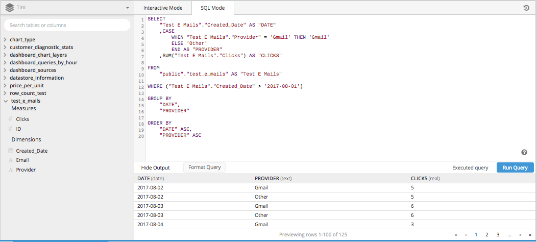

When you piece all three of those columns for one SELECT STATEMENT and throw in the rest of the necessary pieces to build a SQL query, it all take shape below.
Select statement
Then after adding a PIVOT DATA step into the Data Pipeline, we’ll get a table properly arranged in the proper format to set up a line chart showing how clicks are compared over time.
Data analytics

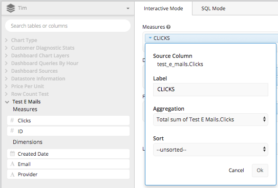

Drag the ‘Clicks Column’ to the measures box and aggregate it by TOTAL SUM of the Column Clicks, then re-label it ‘CLICKS.’
Clicks dropdown

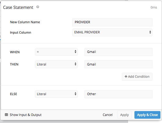

Adding a CASE STATEMENT pipeline step allows us to set the conditions for the WHEN and the ELSE just like we did before, without having to type in the entire SQL syntax.
Case statement window

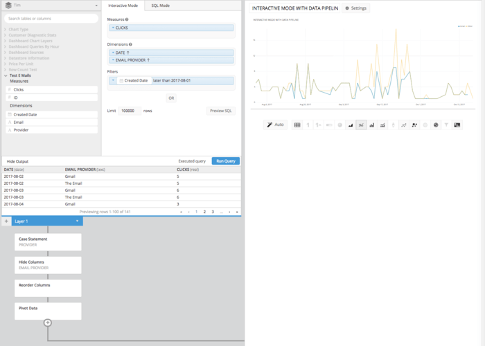

Then after hiding the original ‘Provider’ column and using a REORDER COLUMNS step and a PIVOT DATA step we’ll get the same table arrangement we got in SQL Mode and can present the same table we did in SQL Mode.
Line chart
While it may take a few more clicks and steps than in SQL Mode, the resulting line chart done in Interactive Mode requires no knowledge of SQL Syntax. Instead all it takes is a basic understanding of the principles involved. This is another example of how Atlassian Analytics is helping to put the power of data in everybody’s hands, regardless of SQL knowledge.
