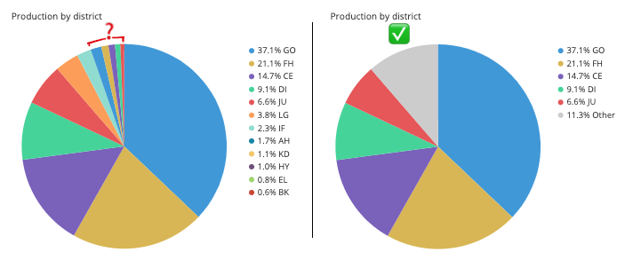

In a qualitative palette, the colors assigned to each group need to be distinct. As a rule of thumb, you should try to limit the maximum palette size to ten or fewer colors. With more colors than this, you start to run into trouble distinguishing between groups. If you have more possible values than colors, then you should try to bundle values together, like setting the smallest categories to a single “other” category. Looping through colors multiple times is a bad idea, as this can cause confusion.
![Pie chart example](https://wac-cdn.atlassian.com/dam/jcr:60eecca0-6c0b-406e-b491-be1c88fc619c/pie-chart-grouping-slices.png?cdnVersion=2079)
The smallest slices on the left not only repeat colors in the palette, they are also fairly difficult to distinguish from one another.

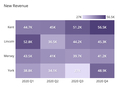

![A heatmap showing new revenue by quarter over sales representative; darker colors indicate a higher amount of sales.](https://wac-cdn.atlassian.com/dam/jcr:873df0e4-35f6-4488-b7c2-643a9ea3cbe6/heatmap-example.png?cdnVersion=2079)
When the variable assigned to be colored is numeric or has inherently ordered values, then it can be depicted with a sequential palette. Colors are assigned to data values in a continuum, usually based on lightness, hue, or both.
![Example of a sequential palette with single hue](https://wac-cdn.atlassian.com/dam/jcr:9402938a-5460-49cb-a994-60f9dd9aaf7a/sequential-palette-example.png?cdnVersion=2079)
The most prominent dimension of color for a sequential palette is its lightness. Typically, lower values are associated with lighter colors, and higher values with darker colors. However, this is because plots tend to be on white or similarly light backgrounds. On a dark background, it’s common to have the reverse case, where higher values are indicated with brighter, lighter colors.
The secondary dimension for a sequential color palette is its hue. It is fine to just use a single hue for your color map, mostly varying lightness to indicate value. However, it’s worth considering spanning between two colors as an additional aid in encoding. Typically, a warmer color (towards red or yellow) will go on the lighter end, with a cooler color (towards green, blue, or purple) on the darker end.

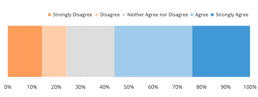

If our numeric variable has a meaningful central value, like zero, then we can apply a diverging palette. A diverging palette is essentially a combination of two sequential palettes with a shared endpoint sitting at the central value. Values larger than the center are assigned to colors on one side of the center, while smaller values get assigned to colors on the opposing side.
![diverging palette](https://wac-cdn.atlassian.com/dam/jcr:aa132091-2195-4222-a9f7-0e7cb2f4cf92/diverging-palette-example.png?cdnVersion=2079)
Typically, a distinctive hue is used for each of the component sequential palettes to make it easier to distinguish between positive and negative values relative to the center. Like with sequential palettes, the central value is generally assigned a light color, so that darker colors indicate larger distance from the center.

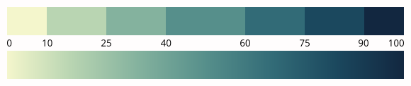

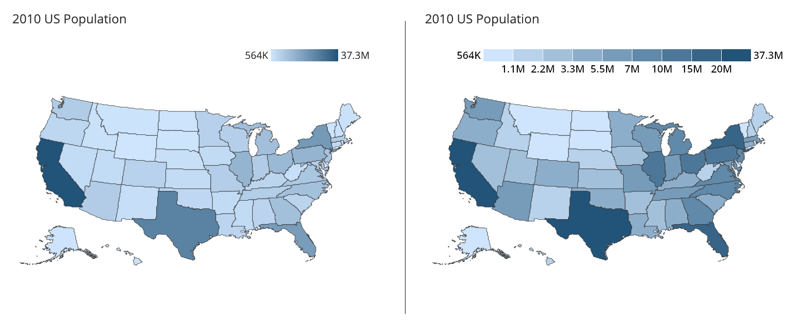

Discrete vs. continuous palette
Sequential and diverging palettes can be associated with data values in two different ways: either as a discrete set of colors, each one associated with a numeric range, or as a continuous function between numeric value and color.
![discrete sequential palette and continuous sequential palette](https://wac-cdn.atlassian.com/dam/jcr:1a3f193f-961b-4655-968e-9486d8601d09/discrete-vs-continuous-palette.png?cdnVersion=2079)
Tools for creating palettes will generally follow the first type, while tools that create visualizations often have the capacity to build a continuous association. While it may seem automatically better to have a continuous function between value and color, there are still merits to the discretized palette.
Our ability to distinguish differences in color is weaker than that of position or length, so we are already at a disadvantage for associating color to precise values. Discretization of values can reduce cognitive load by bringing out the broad patterns in the data. In addition, we can set value ranges for a discrete palette in a way that better represents the data. If the data includes outlier values, then a continuous palette might force most of the data into a narrower value range. Using a discrete color palette means that we can create ranges with unequal size to better represent differences in the data.
![Choropleth of the population of the US in 2010, with continuous and discrete palettes.](https://wac-cdn.atlassian.com/dam/jcr:f2340687-9e19-4859-9c2c-87465f001678/continuous-vs-discrete-choropleth.png?cdnVersion=2079)
One major downside of the discrete color palette is that we lose any ability to compare elements that fall in the same bin. Where there was some color difference between close values with a continuous palette (such as between Texas and California in the example above), none exists in the discrete case.

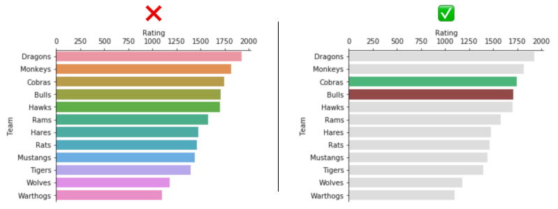

Avoid unnecessary usage of color
Even though color is an important part of data visualization, it’s wise to exercise restraint and only use color where it is appropriate. Not every chart you create will require multiple colors. If you have only two variables to plot, they will likely be encoded by vertical and horizontal positions or lengths. Color usually only comes in when a third variable needs to be encoded into a chart or if it’s a component of a specialist chart like a pie chart. However, there are cases where color can be added to emphasize a specific finding or as an extra highlighting encoding.
![Colors are not necessary in a simple bar chart unless they are used for specific emphasis.](https://wac-cdn.atlassian.com/dam/jcr:2a2ff00e-e9b5-4980-9b55-1c3909c6e47c/color-bestpractices-1.png?cdnVersion=2079)
The rainbow bar colors on the left aren’t meaningful and should be avoided. On the right, most bars are a neutral gray to highlight the comparison of the two colored bars.

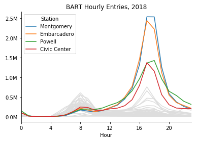

Sometimes, you can leverage how colors are perceived to enhance your visualizations’ effectiveness. If the groups that you are plotting have inherent color conventions, such as with sports teams and political parties, assigning appropriate colors can make it easier for readers to follow a visualization. You may even want to try creating custom palettes around your brand’s colors as a base.
A general rule of thumb is to avoid overly high levels of color saturation and brightness in order to reduce eyestrain. This also allows room for highlighting the elements that are important by giving them a bolder look compared to the other elements. Similarly, the importance of gray cannot be understated to put unimportant data in the background, among other purposes.
![line chart of SF BART ridership](https://wac-cdn.atlassian.com/dam/jcr:6877d8d7-5170-45b8-9ec6-c03b34f72306/color-bestpractices-3.png?cdnVersion=2079)

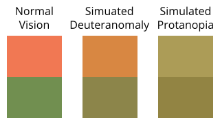

Attend to color blindness
About four percent of the population have some sort of color blindness, most of them males. The most common forms of color blindness cause confusion between certain shades of red and green, though there are also forms of color blindness that cause blue and yellow shades to look the same. For these reasons, it is good to try and vary a dimension other than hue alone to indicate the value associated with a color, like lightness and saturation. You can also use colorblindness simulators like Coblis to get an idea of whether your final visualization will be understandable to others and if there are potential ambiguities.

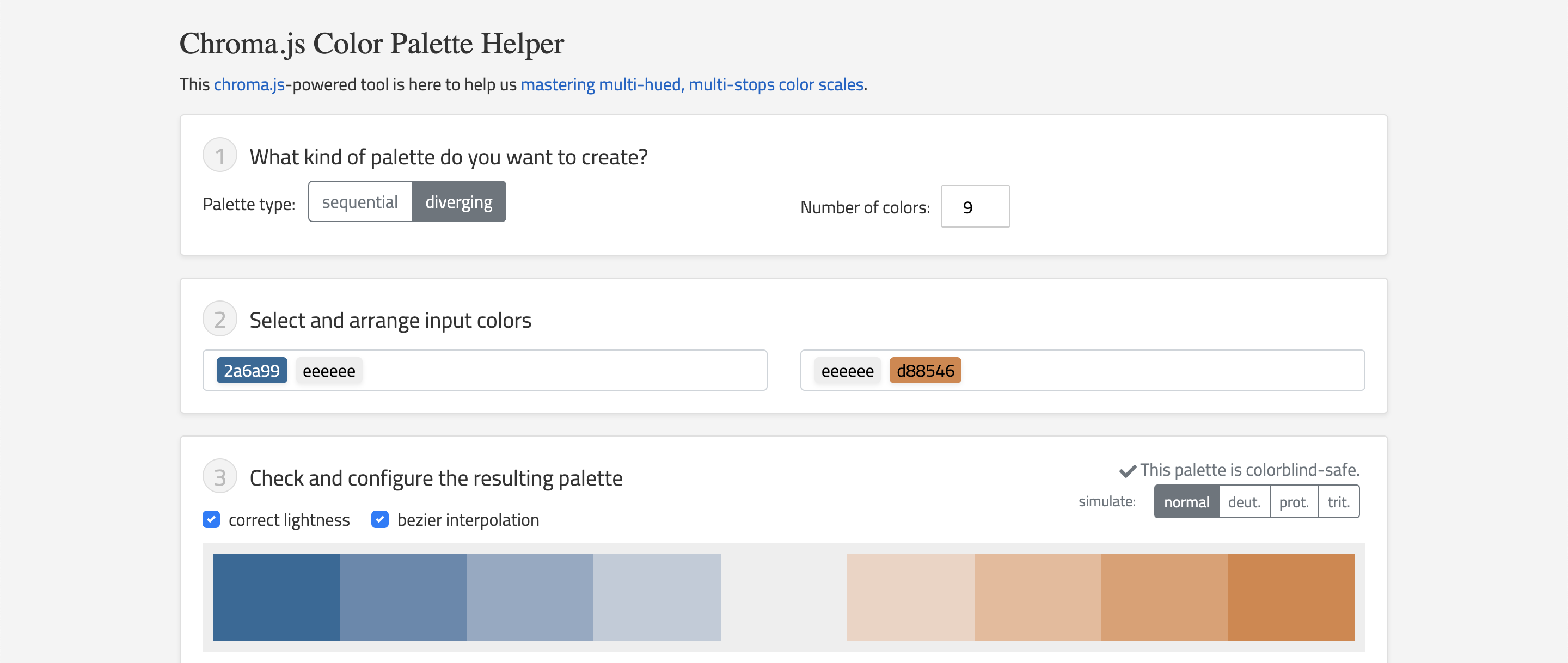

Chroma.js Color Palette Helper
![Screenshot of the chroma.js Color Palette Helper site showing a blue/orange diverging palette.](https://wac-cdn.atlassian.com/dam/jcr:08d2b7aa-5b04-4e36-8656-b1da0d93acc8/chromajs-color-palette-helper.png?cdnVersion=2079)
The chroma.js Color Palette Helper is a little bit more involved than Data Color Picker with its options for correcting lightness, use of bezier interpolation, and slightly more difficult input of color values. However, it also allows for some additional freedom in setting multiple stop-points for the algorithm to try and fit a palette to. As an additional bonus, the application also includes a color blindness simulator on the same page, highlighting the most common types of deficiency where issues may crop up.

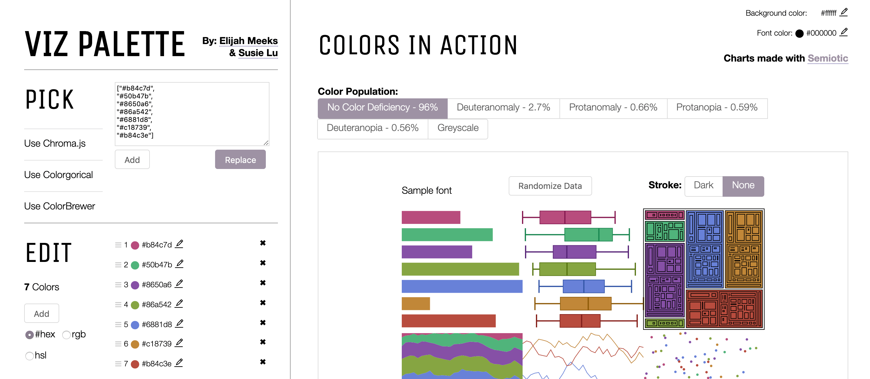

Viz Palette
![Screenshot of the Viz Palette site depicting a random palette generated from i want hue.](https://wac-cdn.atlassian.com/dam/jcr:370aa592-8f17-4f1e-80dd-876ade37a8d9/viz-palette.png?cdnVersion=2079)
In the previous section, Coblis was linked as a resource for checking how your final visualization might look to those with color perception deficiencies. Viz Palette is a broader color palette tool you can use to check your palettes before you put together your visualizations. In addition to being able to view sets of colors in the context of example plots and under simulated color perception deficiencies, you can also modify and change your palette’s colors immediately.
