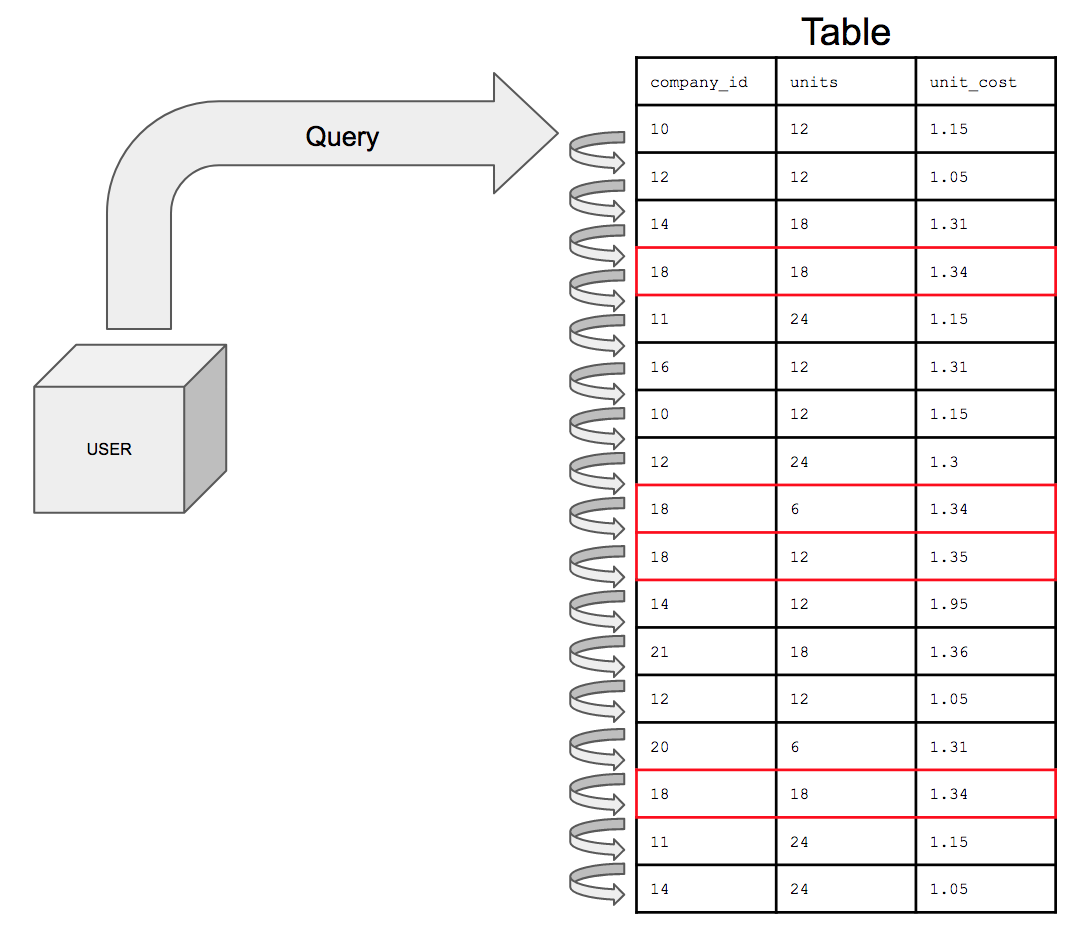

If we were to run the following query:
SELECT
company_id,
units,
unit_cost
FROM
index_test
WHERE
company_id = 18The database would have to search through all 17 rows in the order they appear in the table, from top to bottom, one at a time. So to search for all of the potential instances of the company_id number 18, the database must look through the entire table for all appearances of 18 in the company_id column.

Querying an unindexed table, if presented visually, would look like this:

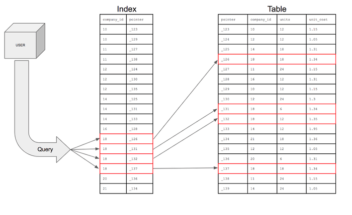

With that index, the query can search for only the rows in the company_id column that have 18 and then using the pointer can go into the table to find the specific row where that pointer lives. The query can then go into the table to retrieve the fields for the columns requested for the rows that meet the conditions.
If the search were presented visually, it would look like this:

Indexing adds a data structure with columns for the search conditions and a pointer
The pointer is the address on the memory disk of the row with the rest of the information
The index data structure is sorted to optimize query efficiency
The query looks for the specific row in the index; the index refers to the pointer which will find the rest of the information.
The index reduces the number of rows the query has to search through from 17 to 4.
