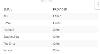

And, the else statement would be ‘Other’ for every other email address provider. The resulting table of this CASE STATEMENT
with corresponding emails alone. Would look like this:
![Email and provider table](https://wac-cdn.atlassian.com/dam/jcr:623c215d-9e24-4eba-9d31-f3e395ad37ea/image1.png?cdnVersion=2079)

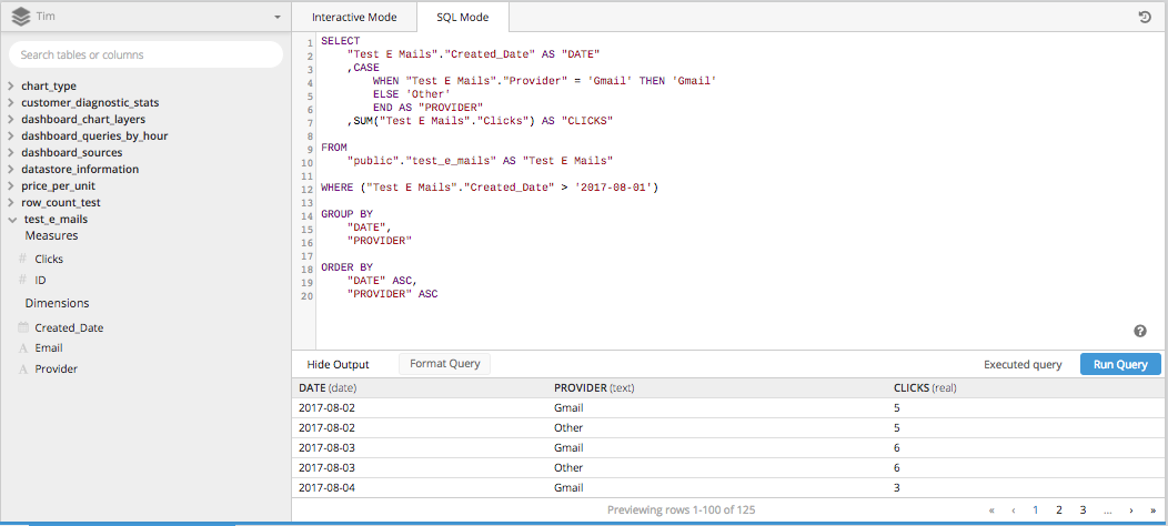

When you piece all three of those columns for one SELECT STATEMENT
and throw in the rest of the necessary pieces to build a SQL query, it all take shape below.
![Select statement](https://wac-cdn.atlassian.com/dam/jcr:1be79bb7-e902-4455-93ef-5302ee35d85b/image2.png?cdnVersion=2079)

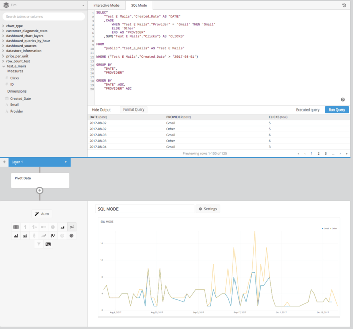

Then after adding a PIVOT DATA
step into the Data Pipeline, we’ll get a table properly arranged in the proper format to set up a line chart showing how clicks are compared over time.
![Data analytics](https://wac-cdn.atlassian.com/dam/jcr:ce8e8f71-9e87-46ec-b45a-8107868c2e9e/image3.png?cdnVersion=2079)

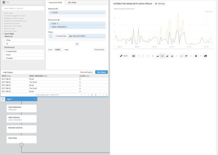

In using Chartio, we can do all of the above without writing any SQL but leveraging the Data Explorer and the Data Pipeline features. After building our underlying query to pull in all the columns we’re going to need SUM OF CLICKS
, DATE
and EMAIL ADDRESS
we can use the Data Pipeline to manipulate this data post-SQL. First, let’s build the query.

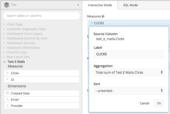

Drag the ‘Clicks Column’ to the measures box and aggregate it by TOTAL SUM
of the Column Clicks, then re-label it ‘CLICKS.’
![Clicks dropdown](https://wac-cdn.atlassian.com/dam/jcr:bcf69493-6c42-4e16-9a3c-84d6429dc507/image4.png?cdnVersion=2079)
Then drag ‘Created Date’ and ‘Provider’ to the dimensions box and re-label them ‘Date’ and ‘Email Provider.’ After that, using the ‘Created Date’ column you can set the date span (or build your WHERE
clause) to be everything after 2017-08-01. This will effectively build everything we need in an underlying query to create the CASE STATEMENT
we did above, in Chartio’s Data Pipeline.

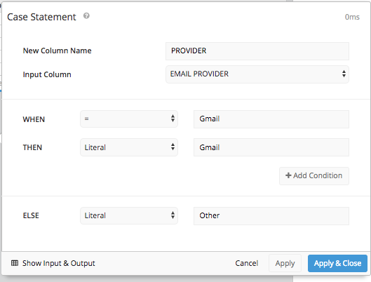

Adding a CASE STATEMENT
pipeline step allows us to set the conditions for the WHEN
and the ELSE
just like we did before, without having to type in the entire SQL syntax.
![Case statement window](https://wac-cdn.atlassian.com/dam/jcr:bb6489c4-1965-4710-bcfc-b8e122672693/image5.png?cdnVersion=2079)
Then after hiding the original ‘Provider’ column and using a REORDER COLUMNS
step and a PIVOT DATA
step we’ll get the same table arrangement we got in SQL Mode and can present the same table we did in SQL Mode.
![Line chart](https://wac-cdn.atlassian.com/dam/jcr:eeb55c65-ef89-4f92-b644-ec3992b8332a/image6.png?cdnVersion=2079)
