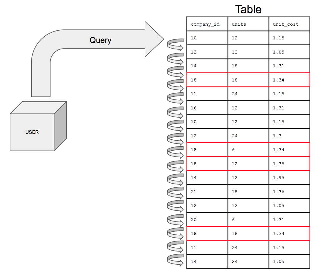

When a table is unindexed, the order of the rows will likely not be discernible by the query as optimized in any way, and your query will therefore have to search through the rows linearly. In other words, the queries will have to search through every row to find the rows matching the conditions. As you can imagine, this can take a long time. Looking through every single row is not very efficient.

company_id = 18 The database would have to search through all 17 rows in the order they appear in the table, from top to bottom, one at a time. So to search for all of the potential instances of the company_id number 18, the database must look through the entire table for all appearances of 18 in the company_id column.
This will only get more and more time consuming as the size of the table increases. As the sophistication of the data increases, what could eventually happen is that a table with one billion rows is joined with another table with one billion rows; the query now has to search through twice the amount of rows costing twice the amount of time.

Querying an unindexed table, if presented visually, would look like this:

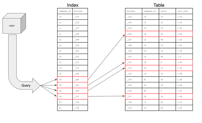

Database indexes will also store pointers which are simply reference information for the location of the additional information in memory. Basically the index holds the company_id and that particular row’s home address on the memory disk. The index will actually look like this:

With that index, the query can search for only the rows in the company_id column that have 18 and then using the pointer can go into the table to find the specific row where that pointer lives. The query can then go into the table to retrieve the fields for the columns requested for the rows that meet the conditions.
If the search were presented visually, it would look like this:

- The query looks for the specific row in the index; the index refers to the pointer which will find the rest of the information.
- The index reduces the number of rows the query has to search through from 17 to 4.
