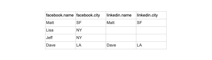

In a LEFT JOIN it brings in every row from the first table “facebook” and joins wherever the join condition is true (facebook.name = linkedin.name) this would be true for both Matt and Dave. So the interim table would have been.
![filtering](https://wac-cdn.atlassian.com/dam/jcr:0d3590f8-1894-466c-8b34-90f012c871fd/filtering.png?cdnVersion=2079)
Then the WHERE clause filters these result to rows where facebook.city = ‘SF’, leaving the one row.

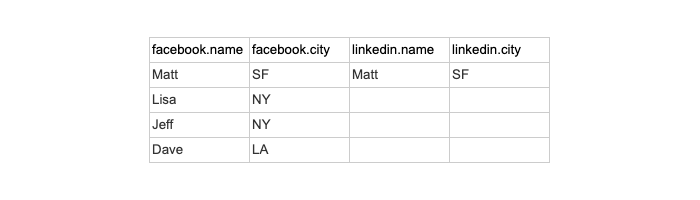

ON facebook.name = linkedin.name AND facebook.city = 'SF'
![](https://wac-cdn.atlassian.com/dam/jcr:69df7633-6f98-4189-90d1-e36cba6b9544/moreFiltering.png?cdnVersion=2079)
The join condition is different in this query. The LEFT JOIN brings in every row and the data that is JOINed in from linkedin only happens when facebook.name = linkedin.name AND facebook.city = ‘SF’. It does not filter out all of the rows that didn’t have facebook.city = ‘SF’
