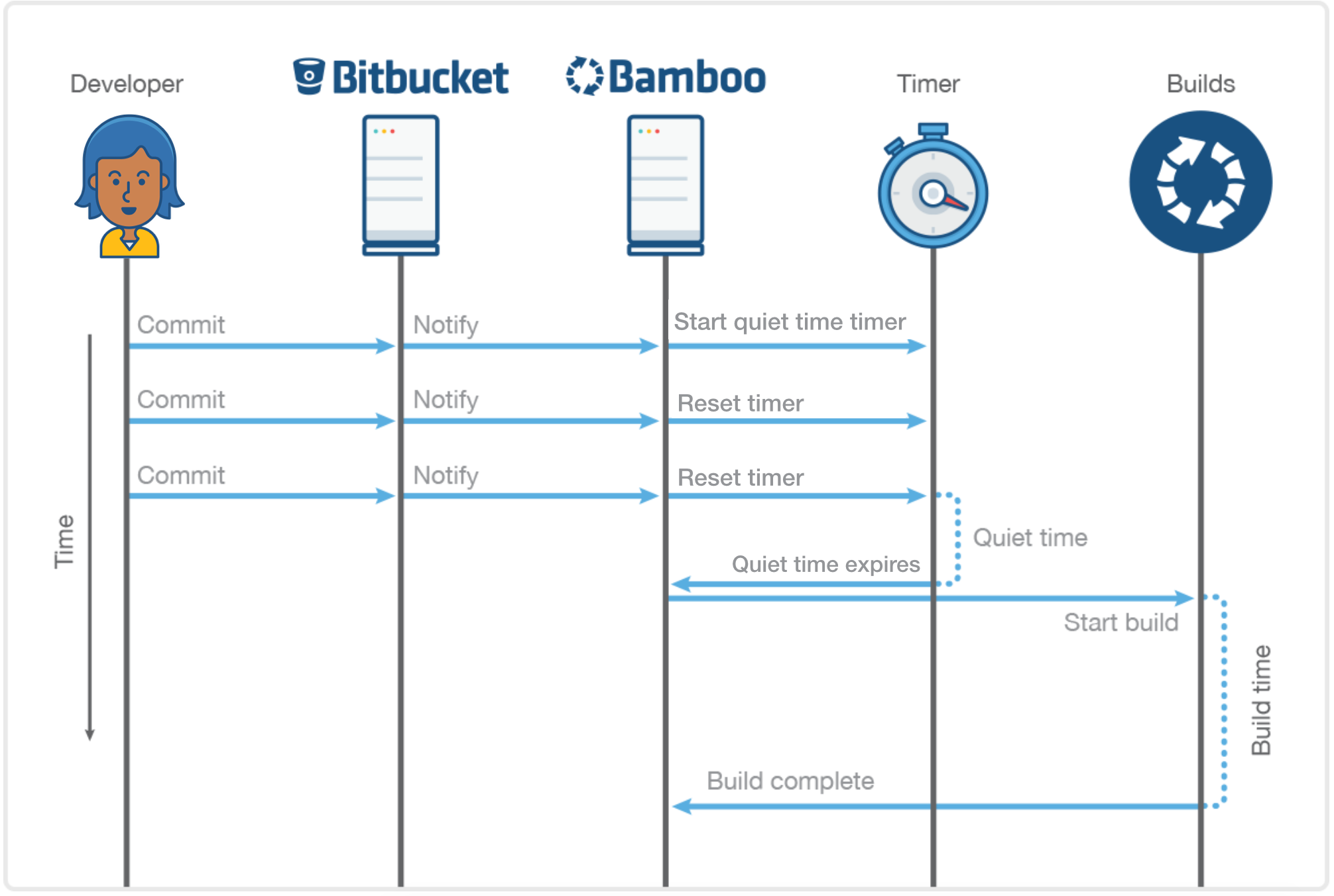

Bamboo is a continuous integration and delivery tool, and part of that continuous word implies to running builds per commit. However, spinning up builds per commit is expensive and time consuming, and knowing that commits often happen in a rushed fast wavy way, it might be more convenient waiting for the blast to end before attempting a build. Though this is all to your team to decide we have a feature in Bamboo that makes this silent wait possible. Bamboo's "quiet period" feature allows aggregating multiple commits per build, so reduces the costs and helps teams get faster feedback. It's an optional setting on each repository connected to Bamboo. After a commit has been made to the repository, the quiet period (if enabled) tells Bamboo how long to wait before kicking off the build.

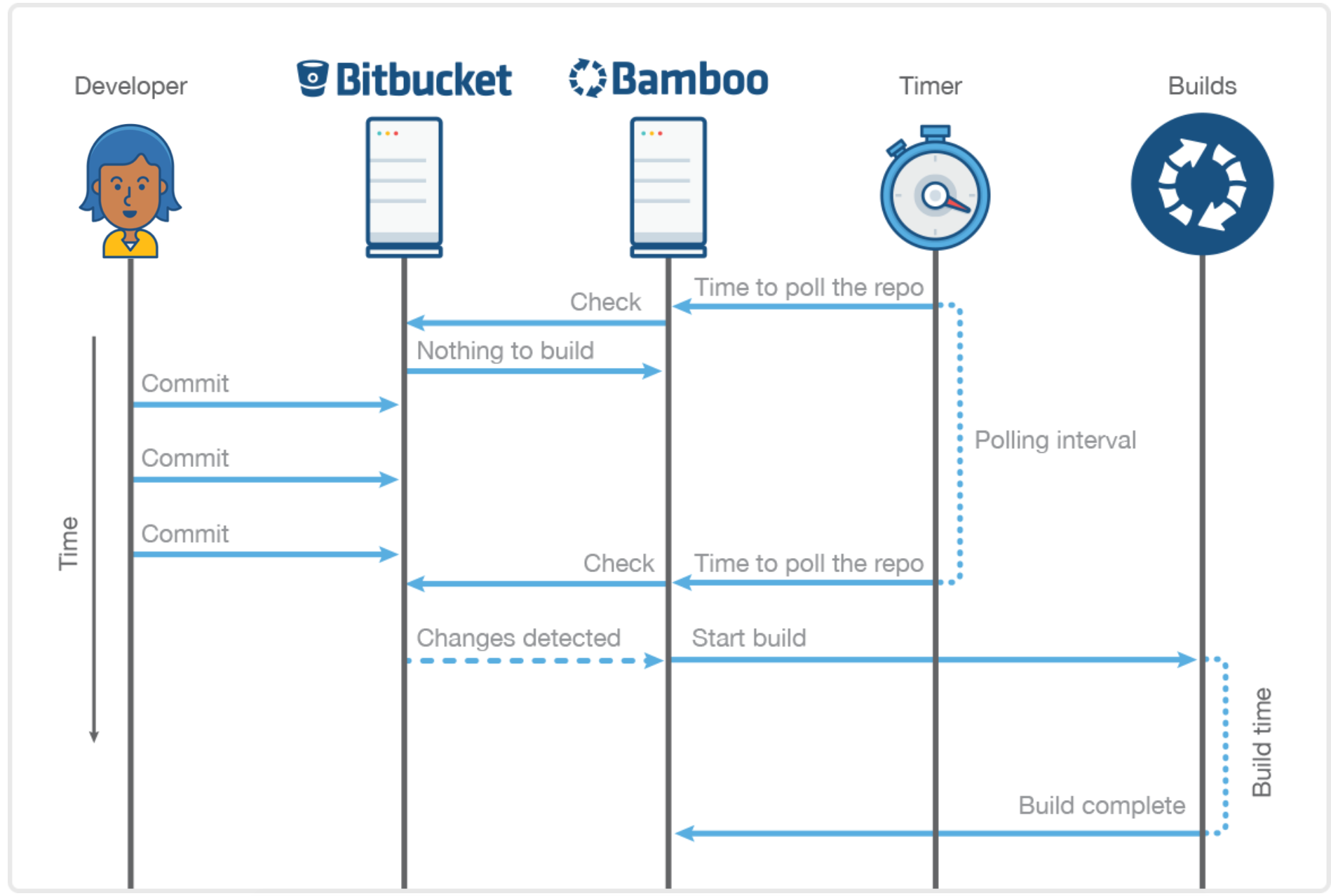

The quiet period comes into play if the repository is configured to notify Bamboo when commits are made. If not, and Bamboo is polling the repository for changes, then the quiet period is effectively moot because the polling period acts as a way to coalesce multiple commits into a single build (as the following diagram shows).
Note: The diagram is not to scale (imagine the build time is substantially larger in real life). This is one of the rare occasions that polling could be considered useful.

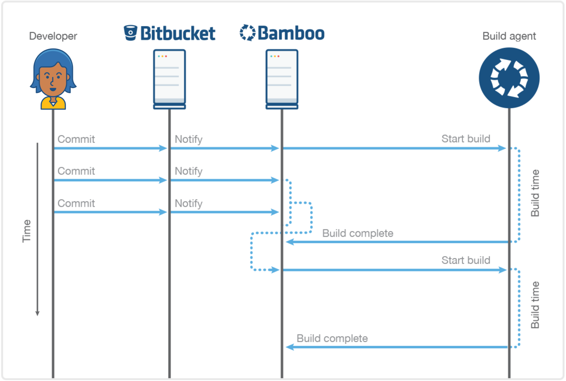

The main use case for the quiet period is when you have a long build and you don’t want to deprive other developers who commit changes just moments after yours from boarding the same train (so to speak). Generally you want to avoid long builds, but that’s not always possible. If a build takes a long time (say an hour) and someone commits just after you then they would have to wait almost two hours for their build result. If only the train would wait a few minutes to allow a few people to get on board before starting!

Consider turning on the quiet period for builds that run long (say, over an hour) and are triggered by a call from the repo (as opposed to builds that poll the repo at intervals). The quiet period will hold the build at the station a little bit so that a few more commits can get on the train. Since build duration is the largest value here (remember the diagram is not to scale), it is only a small delay for the first committer but a large time saving for the second and third. So overall, it’s a good thing.
Following shows how only one build is triggered for the three commits:
