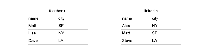

The way both of these clauses can be used to help join data is through defining the condition on which the two tables are joined. To demonstrate this, lets use an example data set of facebook friends and linkedin connections.
![facebook vs linkedin](https://wac-cdn.atlassian.com/dam/jcr:22808ccc-1d69-4a86-897b-736ef80708b7/fbAndLinkedin.png?cdnVersion=2079)

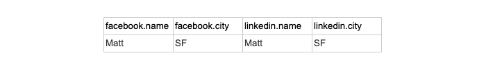

We want to see the people who are both our friend and our connection. So in this case it would only be Matt. Lets now query using a variety of defining the JOIN condition.
All three of these queries produce the same correct result:

![names and city](https://wac-cdn.atlassian.com/dam/jcr:1401d98b-3a11-4068-9b7e-7afd09211e17/namesAndCities.png?cdnVersion=2079)
The first two are types of explicit joins and the last is an implicit join. An explicit JOIN explicitly tells you how to JOIN the data by specifying the type of JOIN and the join condition in the ON clause. An Implicit JOIN does not specify the JOIN type and use the WHERE clause to define the join condition.

Both the ON and WHERE clause can be used to filter data in a query. There are readability and accuracy concerns to address with filtering in the ON clause. Let’s use a slightly larger data set to demonstrate this.
![](https://wac-cdn.atlassian.com/dam/jcr:3f7ec6bd-8321-4e7e-aa73-a73204d4f494/table.png?cdnVersion=2079)
This time we are looking for which people are both our friends and connections, but we only want to see the one(s) who also live in SF.

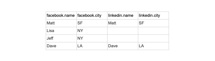

In a LEFT JOIN it brings in every row from the first table “facebook” and joins wherever the join condition is true (facebook.name = linkedin.name) this would be true for both Matt and Dave. So the interim table would have been.
![filtering](https://wac-cdn.atlassian.com/dam/jcr:0d3590f8-1894-466c-8b34-90f012c871fd/filtering.png?cdnVersion=2079)
Then the WHERE clause filters these result to rows where facebook.city = ‘SF’, leaving the one row.

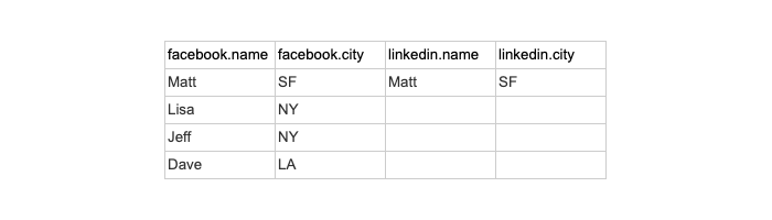

ON facebook.name = linkedin.name AND facebook.city = 'SF'
![](https://wac-cdn.atlassian.com/dam/jcr:69df7633-6f98-4189-90d1-e36cba6b9544/moreFiltering.png?cdnVersion=2079)
The join condition is different in this query. The LEFT JOIN brings in every row and the data that is JOINed in from linkedin only happens when facebook.name = linkedin.name AND facebook.city = ‘SF’. It does not filter out all of the rows that didn’t have facebook.city = ‘SF’
