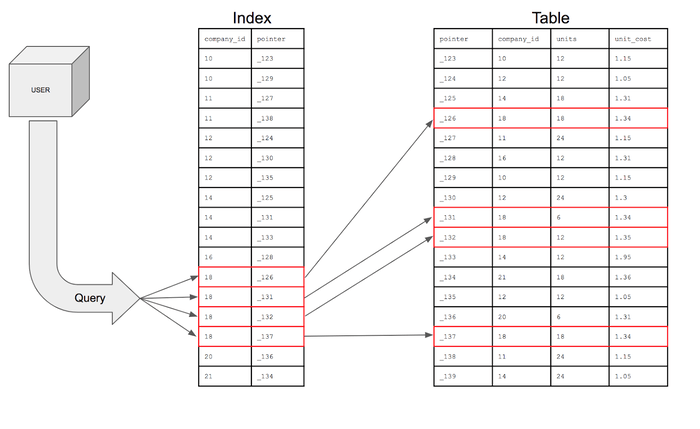

With that index, the query can search for only the rows in the company_id column that have 18 and then using the pointer can go into the table to find the specific row where that pointer lives. The query can then go into the table to retrieve the fields for the columns requested for the rows that meet the conditions.
If the search were presented visually, it would look like this:

- The query looks for the specific row in the index; the index refers to the pointer which will find the rest of the information.
- The index reduces the number of rows the query has to search through from 17 to 4.
