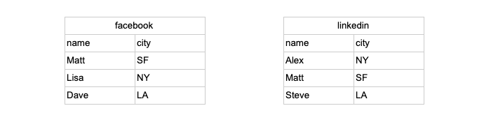

The way both of these clauses can be used to help join data is through defining the condition on which the two tables are joined. To demonstrate this, lets use an example data set of facebook friends and linkedin connections.
![facebook vs linkedin](https://wac-cdn.atlassian.com/dam/jcr:22808ccc-1d69-4a86-897b-736ef80708b7/fbAndLinkedin.png?cdnVersion=2079)
We want to see the people who are both our friend and our connection. So in this case it would only be Matt. Lets now query using a variety of defining the JOIN condition.
All three of these queries produce the same correct result:

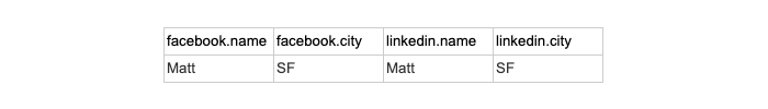

This time we are looking for which people are both our friends and connections, but we only want to see the one(s) who also live in SF.
Nie ograniczanie się do Agile
Let’s evaluate how readable each option is, these two queries will produce the same output:
SELECT *
JOIN linkedin
ON facebook.name = linkedin.name
WHERE facebook.city = 'SF'
SELECT *
FROM facebook
JOIN linkedin
ON facebook.name = linkedin.name AND facebook.city = 'SF'
![](https://wac-cdn.atlassian.com/dam/jcr:1401d98b-3a11-4068-9b7e-7afd09211e17/namesAndCities.png?cdnVersion=2079)
The first query is clear, each clause has its own purpose. The second query is more difficult to understand because the ON clause is being used to both JOIN the data and filter it.

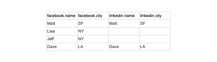

In a LEFT JOIN it brings in every row from the first table “facebook” and joins wherever the join condition is true (facebook.name = linkedin.name) this would be true for both Matt and Dave. So the interim table would have been.
![filtering](https://wac-cdn.atlassian.com/dam/jcr:0d3590f8-1894-466c-8b34-90f012c871fd/filtering.png?cdnVersion=2079)
Then the WHERE clause filters these result to rows where facebook.city = ‘SF’, leaving the one row.

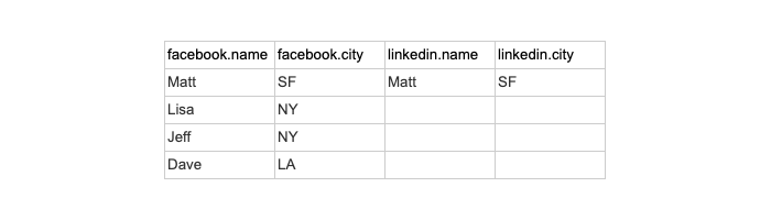

SELECT *
FROM facebook
LEFT JOIN linkedin
![](https://wac-cdn.atlassian.com/dam/jcr:69df7633-6f98-4189-90d1-e36cba6b9544/moreFiltering.png?cdnVersion=2079)
The join condition is different in this query. The LEFT JOIN brings in every row and the data that is JOINed in from linkedin only happens when facebook.name = linkedin.name AND facebook.city = ‘SF’. It does not filter out all of the rows that didn’t have facebook.city = ‘SF’
