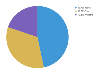

The pie chart above depicts the distribution of votes for a fictional election for a small city. We can see that Reyes, represented by the first blue slice, has just less than half of the votes. Chu (yellow) is in second, with about a third of the votes, while Williams (purple) is last, with about a fifth of the votes. The annotations in the upper right give us a more precise judgment of the proportions, but the pie chart tells the overarching story of where the votes fell.

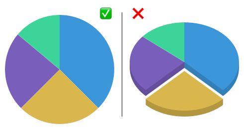

Avoid distorting effects
Reading a pie chart accurately requires that the slices’ areas, arc lengths, and angles all point to an accurate representation of the data. While avoiding 3-d effects is a good idea for any plot, it is especially important for pie charts. Squashing or stretching the circle or adding unnecessary depth can easily distort how large each slice compares to the whole.
Another distortion can come from the ‘exploded’ pie chart, where slices are pulled out from the center for emphasis. This emphasis comes with a cost, where the gaps can make it more difficult to actually gauge the part-to-whole comparison.

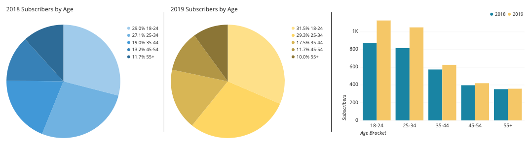

There may be cases where you will want to compare multiple pies to one another: for example, comparing user demographic distribution across multiple years. However, this runs into a similar issue as the previous section, where you want to compare groups to one another. Even worse, it’s a comparison between pies, so you can’t rely on the order of slices as easily for the comparison. Expressing the data using a different plot, like stacked bar chart, grouped bar chart, or line chart, is often a better choice when this kind of group-to-group comparison is desired. Like with actual pies, pie charts are best taken one at a time.
Comparison of the pies may imply a shrinking of the older age groups by proportion, but the grouped bar chart demonstrates a growth in the younger groups.
