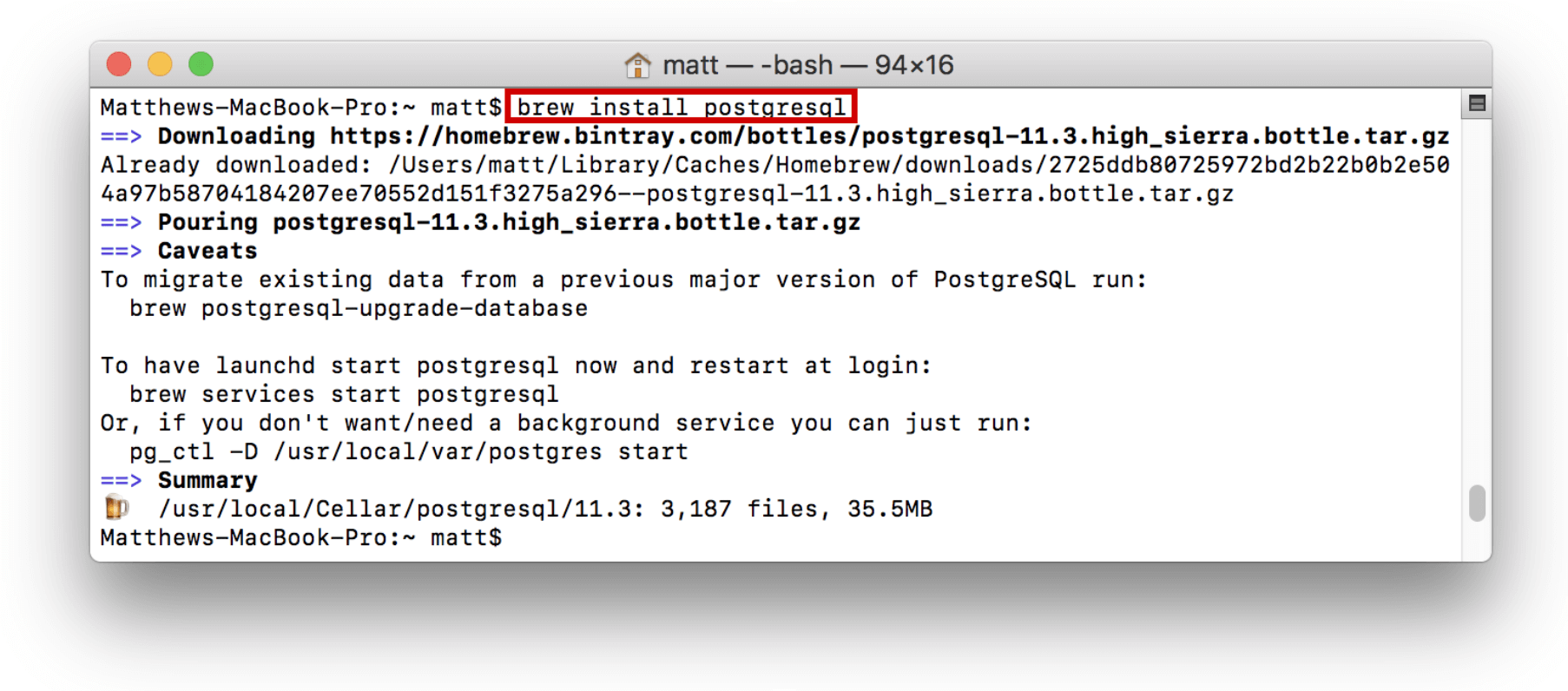

Homebrew is a powerful package manager with many uses, including installing and running postgreSQL. This can be done by typing the following command into a terminal:
![Picture showing the command "brew install postgres" running.](https://wac-cdn.atlassian.com/dam/jcr:eb6aebd9-8358-43fb-a2c2-e431a11389b6/installWithHomebrew.png?cdnVersion=2079)

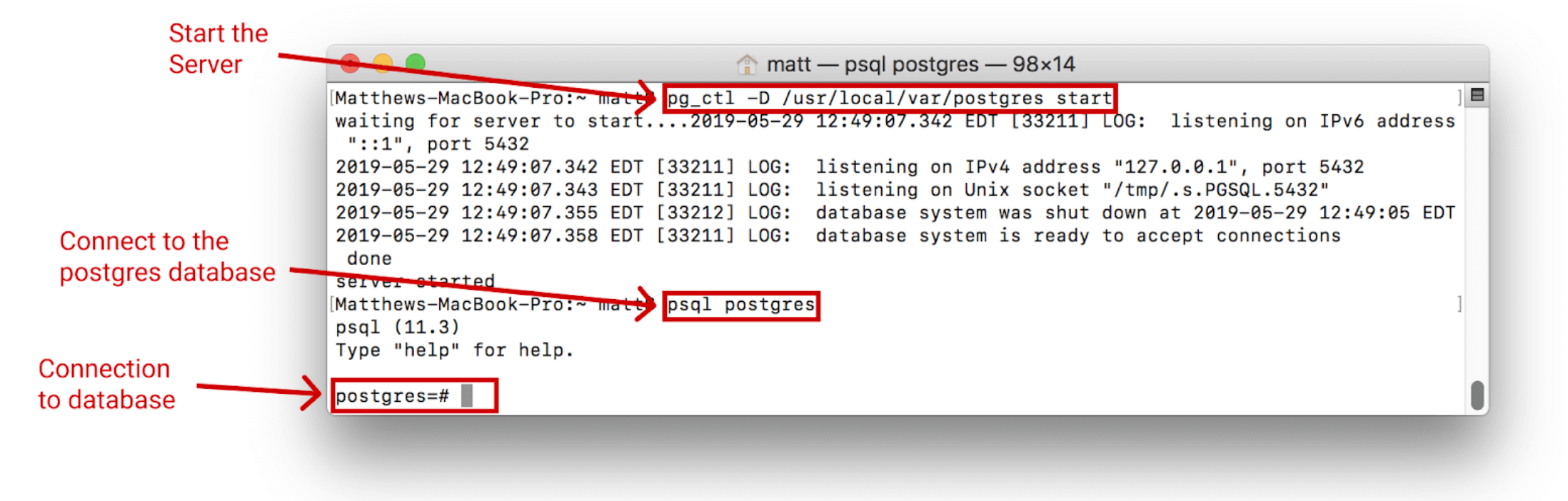

It can now be accessed by typing the following command:
psql postgres
This will connect to the server and access the postgres database. Once this is done:

The process should look like this:
![Shows the server being started and then being connected to.](https://wac-cdn.atlassian.com/dam/jcr:307665ea-a2c0-4969-94a9-bff3a671d5d0/startServerFromCLI.png?cdnVersion=2079)
This shows that the server has been started and can be connected to.

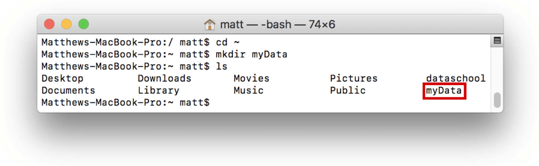

A custom data directory can also be used for a server. To do this, first create a directory to be used as the server location. For example, create a directory called myData in the home directory:
![Shows the creation of a custom data directory](https://wac-cdn.atlassian.com/dam/jcr:52a6b74e-328f-42fe-8056-74efc5a1364c/showCustomDataDirectory.png?cdnVersion=2079)

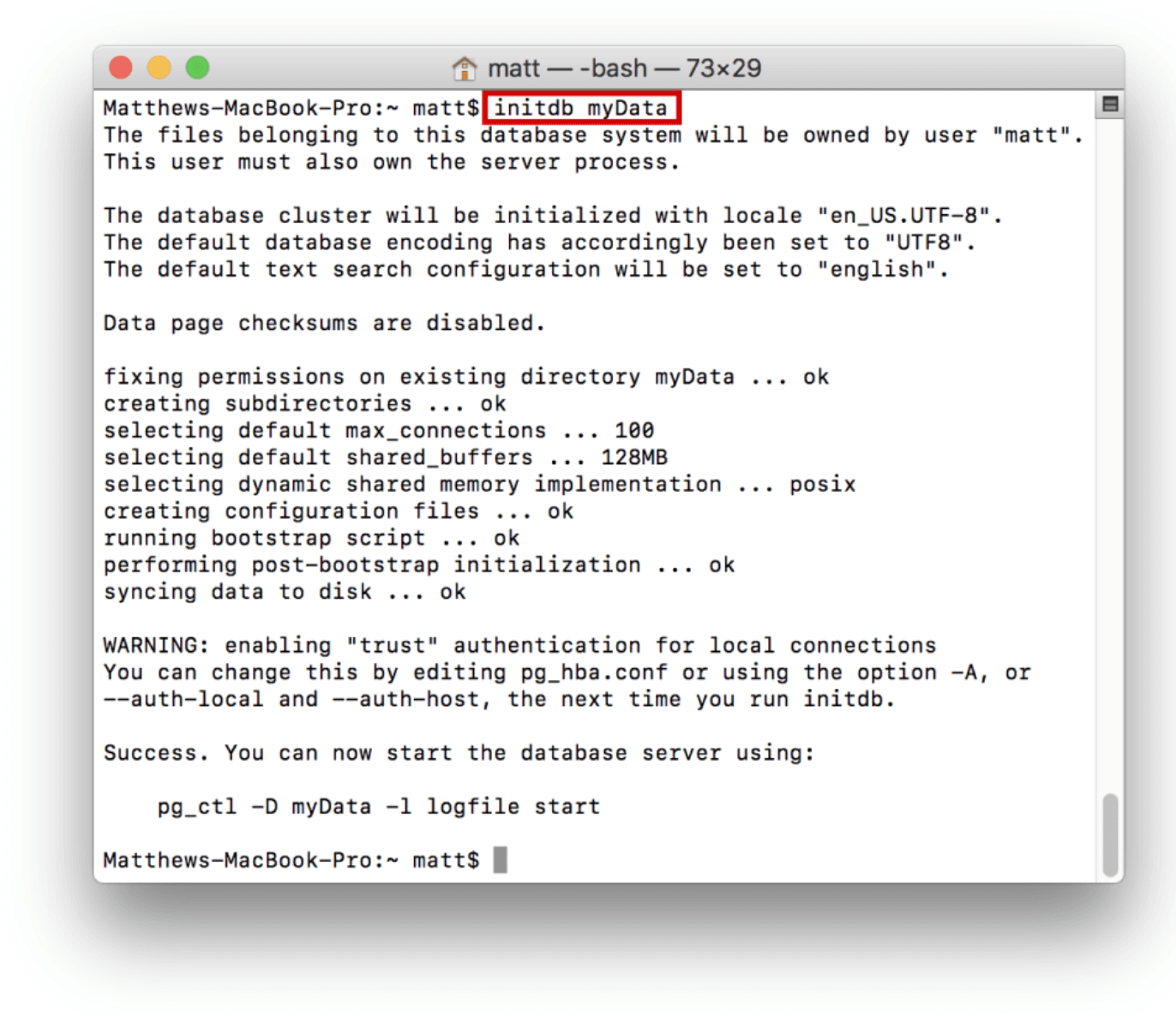

Once the directory is created, the server can be initialized. This means that we configure the directory and add the necessary files to run the server. To do this run the initdb
command as shown:
![shows the execution of initdb on the custom data directory](https://wac-cdn.atlassian.com/dam/jcr:9e140f61-1d97-47a9-b5fa-68a59e434f94/runningInitdb.png?cdnVersion=2079)

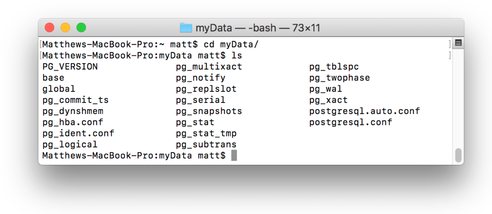

This will fill the myData directory with files necessary to run the server:
![shows contents of the data directory after running initdb successfully](https://wac-cdn.atlassian.com/dam/jcr:665836b6-b6f1-487e-ade9-f2241a4f59c6/initdbResults.png?cdnVersion=2079)

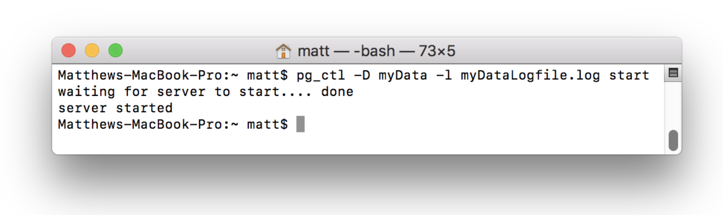

Now that the server is initialized and the log file is created, you can start the server from this directory. To do this use the command and substitute in for the specified values:
pg_ctl -D [Data Directory] -l [Log file] start

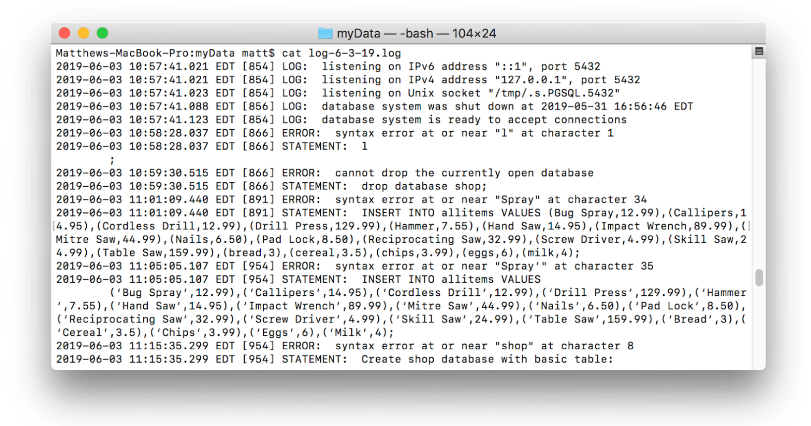

The “Data Directory” refers to the directory that was just initialized (in this case myData). The “Log file” is a file that will record server events for later analysis. Generally log files are formatted to contain the date in the file name (e.g. “2018-05-27.log” or “myData-logfile-2018-05-27.log”) and should be stored outside of the database that they are logging so as to avoid unnecessary risks. Log files can be dense to read but are very useful for security and debugging purposes:
![shows the contents of a sample log file.](https://wac-cdn.atlassian.com/dam/jcr:c17e7673-dca1-4fb6-964e-7f8782dafd72/sampleLogfile.png?cdnVersion=2079)
The command above will generate a log file like the one shown, start the server, and tie the log file to the server. If a log file is not specified, events will be logged to the terminal:
![starting a server with a log file using pg](https://wac-cdn.atlassian.com/dam/jcr:0325550f-4a5e-4967-ba26-8b17b87323e3/startingServerWithLogfile.png?cdnVersion=2079)

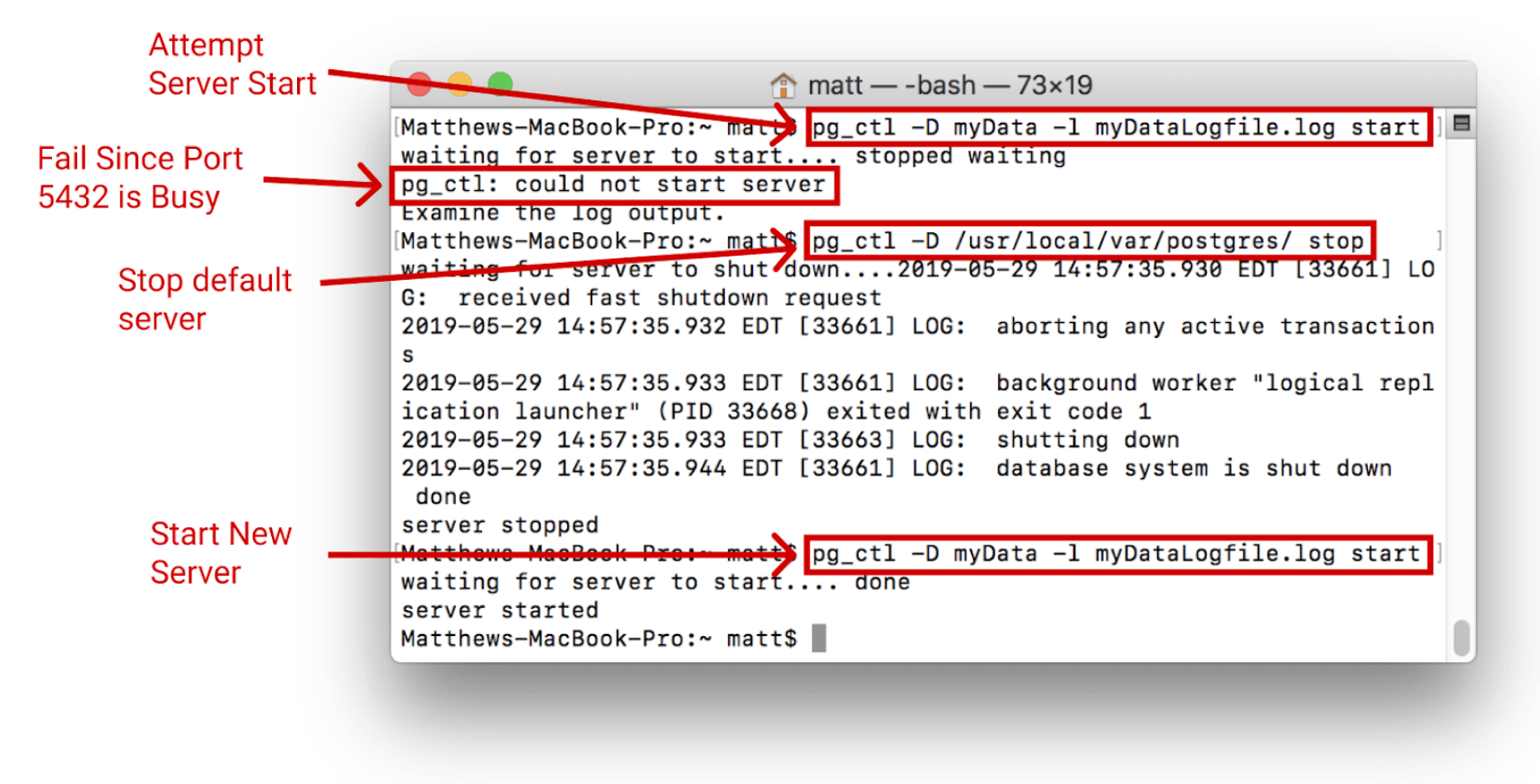

The server will only start if the port is free. If the default server is running it must first be stopped using the pg_ctl -D /usr/local/var/postgres stop
command:
![Shows a conflict between two servers where one is on port 5432 so the second cannot start on port 5432 as well](https://wac-cdn.atlassian.com/dam/jcr:d33afd13-dfdf-4dc3-893f-bf8feda70d84/serverPortConflict.png?cdnVersion=2079)

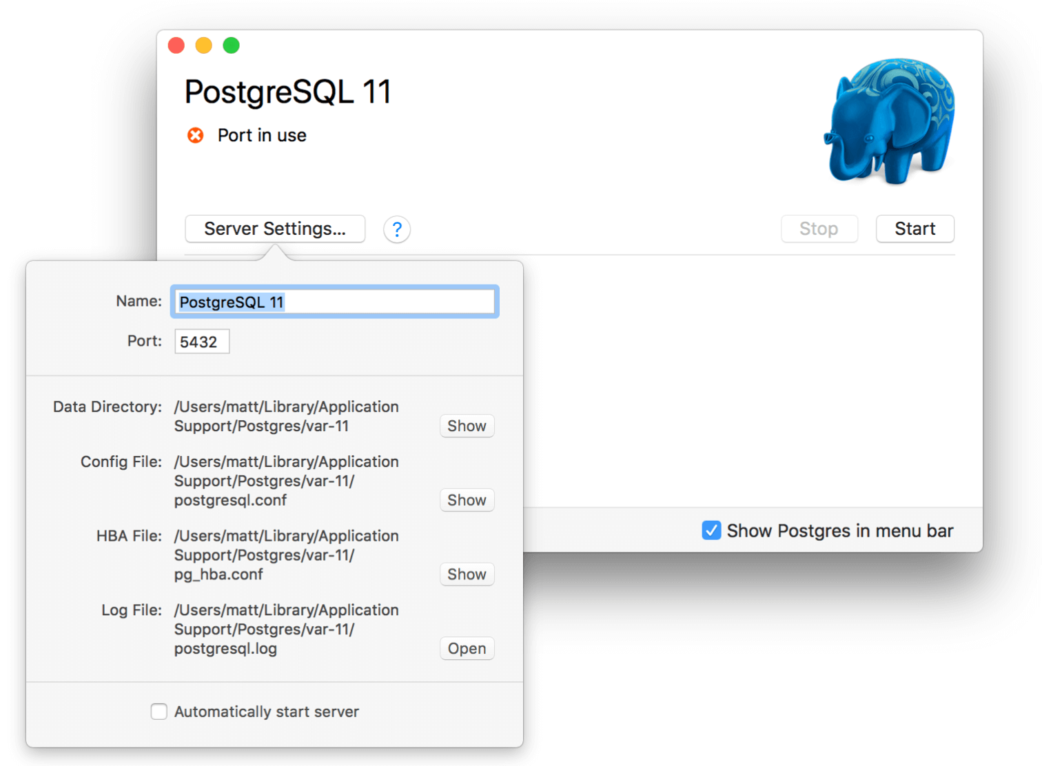

This will start the server. Details on the server can be found by opening the server settings:
![Shows how to edit settings in the postgres app](https://wac-cdn.atlassian.com/dam/jcr:512240e8-99d2-4e72-8035-c9b4d73773b7/serverSettings.png?cdnVersion=2079)
This interface shows all the essential information regarding the server. It also allows the port to be changed very easily. This is useful because multiple PostgreSQL servers can

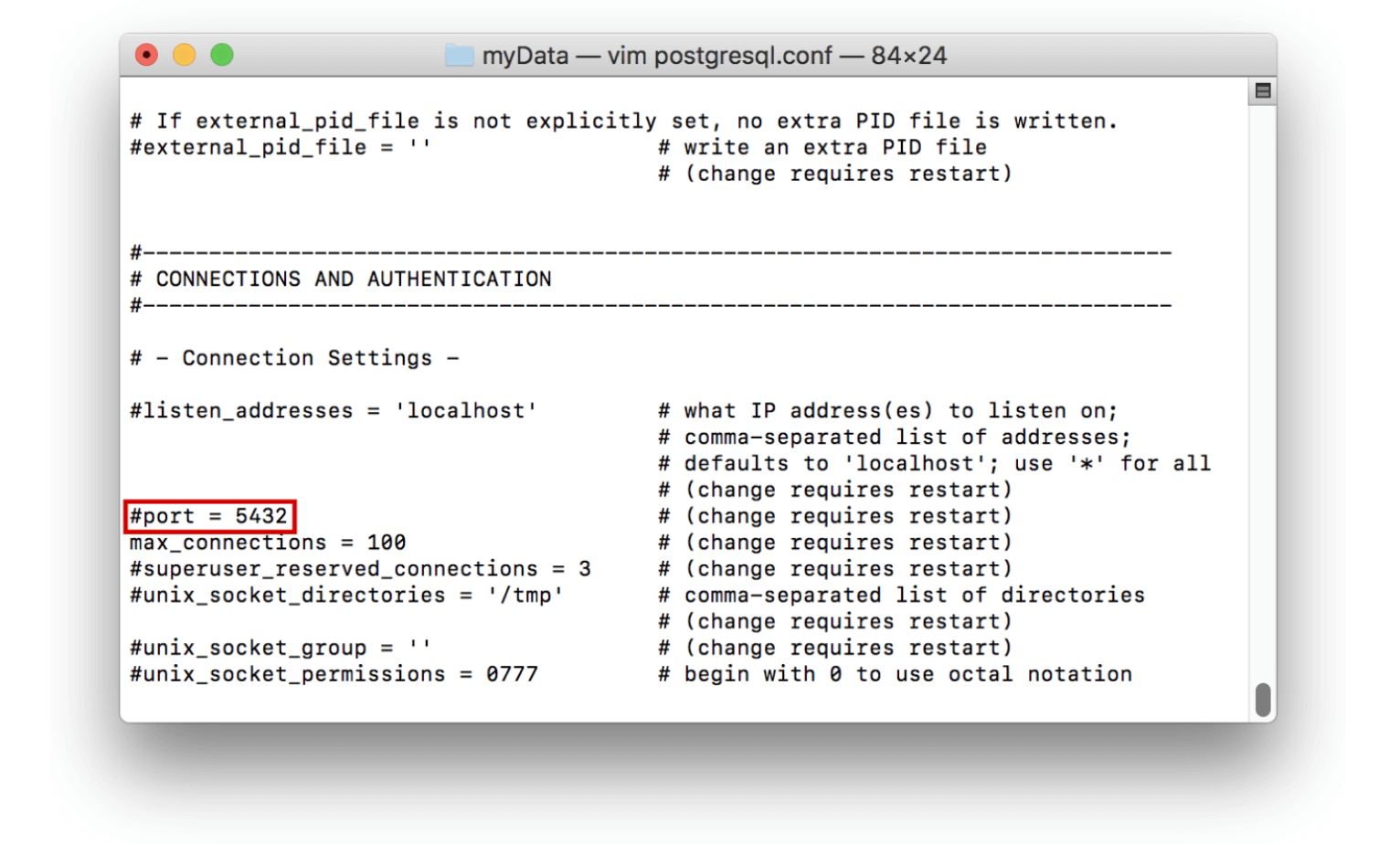

Note: To change the port in the terminal, the ‘postgres.conf’ file (which can be found in the data directory) must be edited. This looks like the following:
![shows how to edit the port in the command line interface by editing the .conf file](https://wac-cdn.atlassian.com/dam/jcr:acf13411-39df-4095-93e4-eea1a1cebf98/editingTheConfFile.png?cdnVersion=2079)
