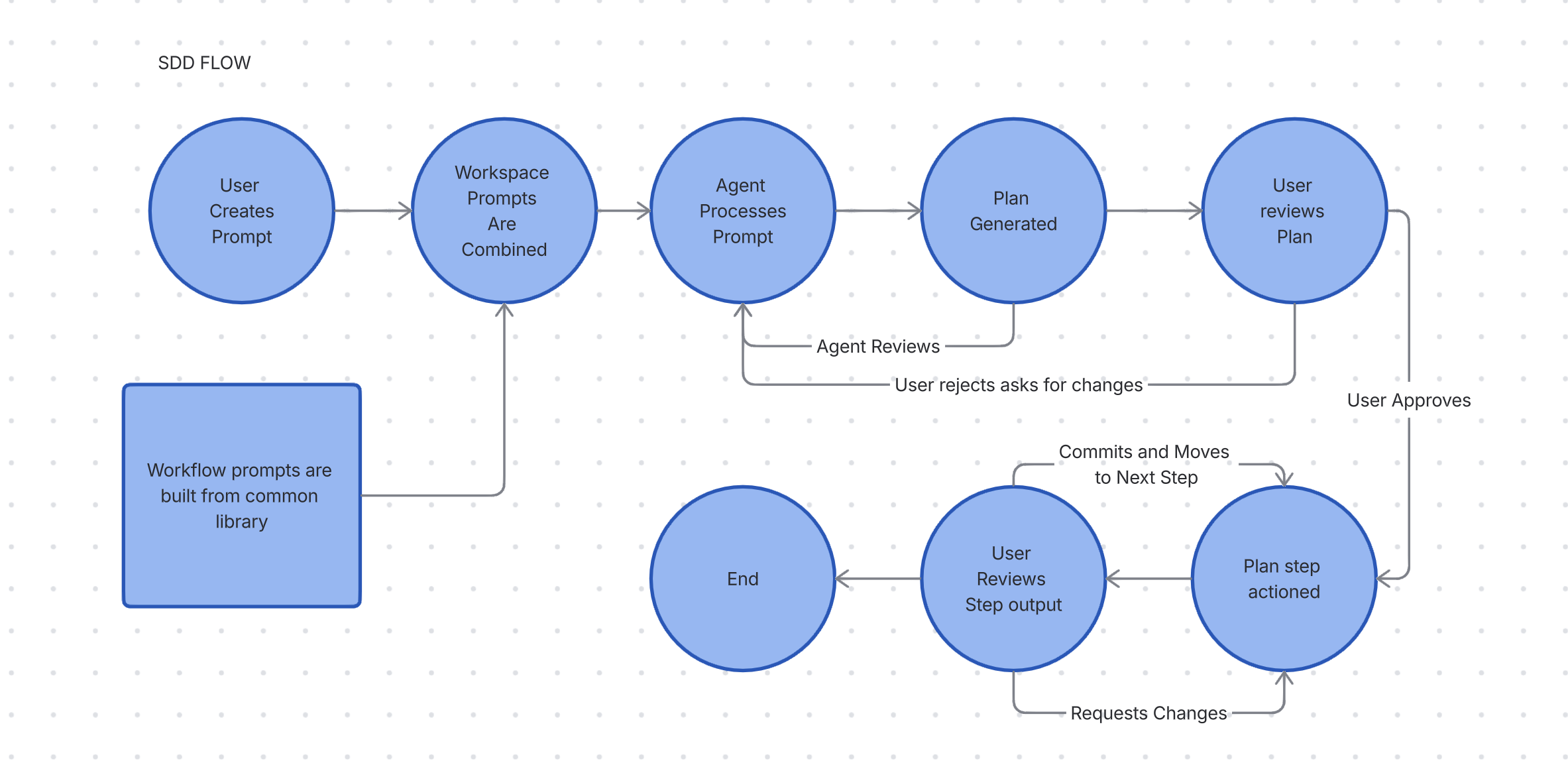

With SDD we:
  • Setup firm standardised guide rails.
  • We have multiple opportunities to course correct and intervene.
  • We make changes in small logical steps that can be reviewed in isolation.

The initial plan was flawed; it assumed something I caught and fixed. It aimed to delete a file that needed to be kept. Using a normal prompt, it would have proceeded with that deletion. Remember, the key step is reviewing and refining the plan through back-and-forth with the agent, for example:
We should not delete delete-comprehensive-benchmark.sh its a WIP and is being worked on.
Once I was happy with the plan I then asked the agent to execute. It then followed the plan step by step, letting me review and adjust as we went.
This example shows the feedback loop we create by adding pre-planned process steps. We understand the agent’s intent and planned process before it starts, so we can fix incorrect assumptions. This is powerful, it lets us see the justification for why agents plan to do something actions and it allows us to break changes into smaller, clearer tasks.
