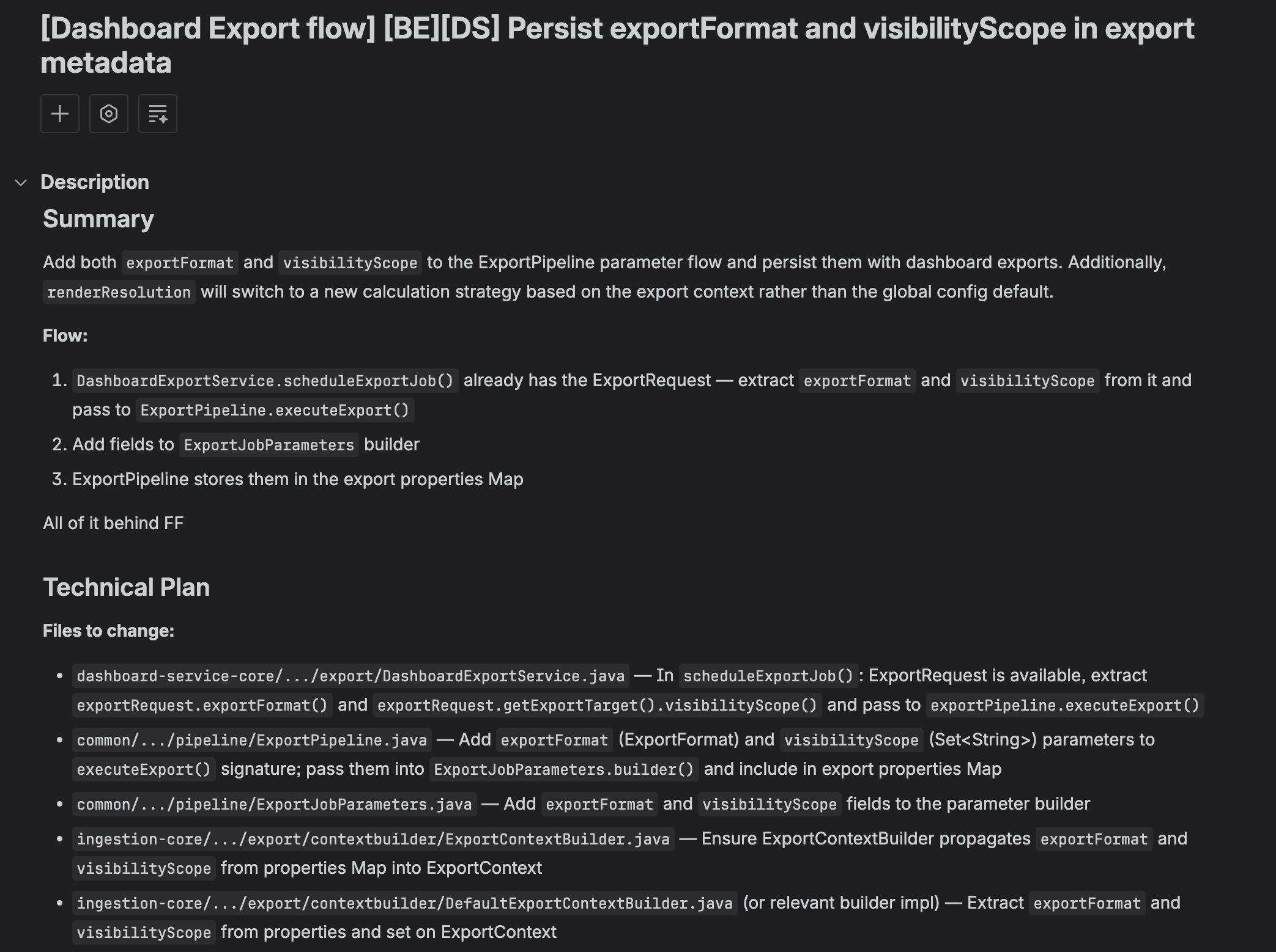

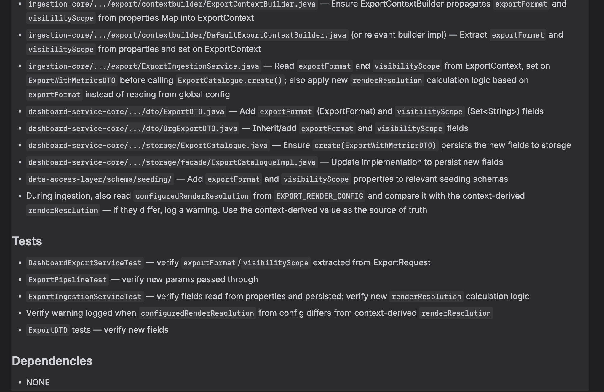

Simple example of such Specs in Work Items
Low level Specs example

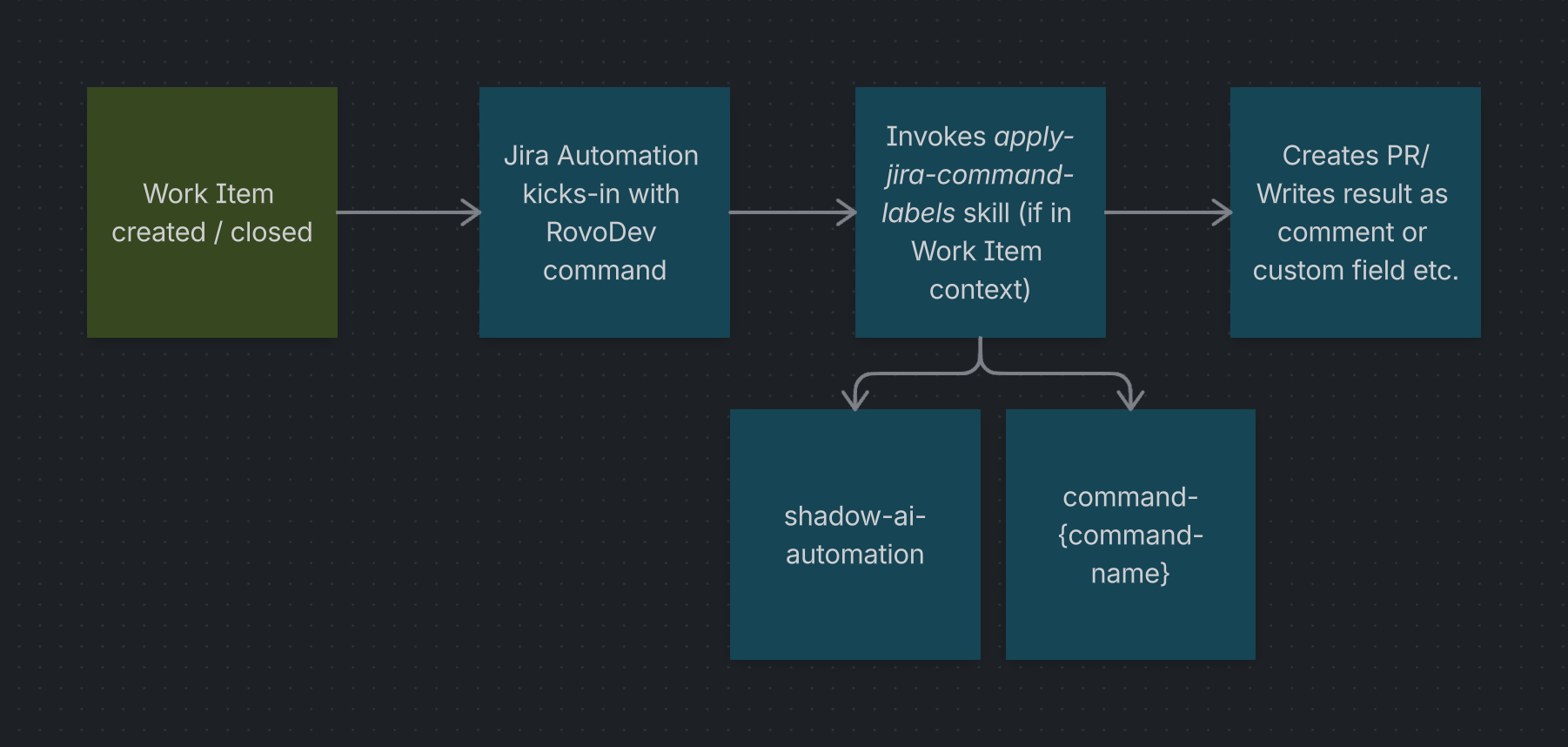

This is a general outline of the steps involved in executing our prompts via Jira automations with the Rovo Dev platform
For instance, here is the workflow we use to analyze threads in our help channel.
  1. An internal help channel Work Item is closed.
    • Feedback and any pending queries may cause the Work Item to transition to the ‘Analysis’ state before final closure is granted.
  2. Jira automation is triggered.
  3. The automation updates Work Item labels by invoking a skill that retains the original name of the executed command.
  4. The system analyzes conversation threads and stores the resulting data in a custom field

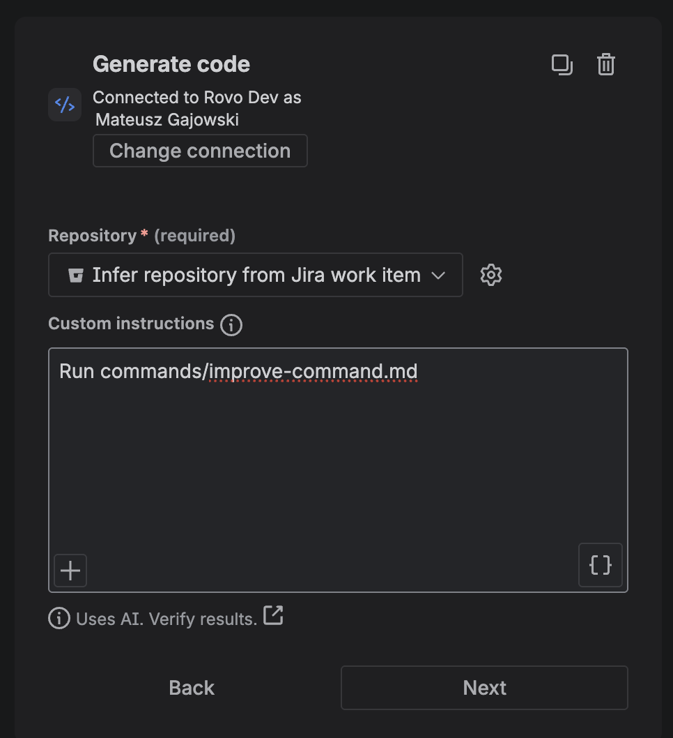

  3. Jira Automation kicks in and invokes the improve-command stored prompt (which we have in our repository and use both directly in Rovo Dev CLI and in this automation)
Executes command via Rovo Dev “Generate code” action.
Note: The setting “Infer repository from Jira work item“ makes Rovo Dev try to infer the repository URL from your Work Item before starting the session. Ensure you mention your repository in the description – just “Use {workspace}/{repository name} repository“ should suffice!
Automation
Generate code step
  1. The command checks whether it’s running in a Work Item context and looks for a command-{command/skill name} label
    1. If it’s not running with Work Item context, because someone has executed it locally, it will ask for the proper context
  2. It finds the original command file based on the label
  3. Applies the improvements
  4. Creates a pull request
