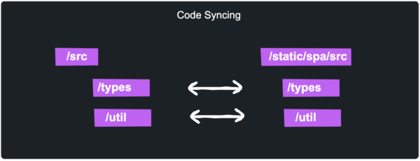

There are some clever solutions to solve this, but I’ve been happy enough with a simple solution that’s based on a shell script that I run whenever I create or change code that needs to be shared. This relies on shared code being located in well known locations. In my case, the typical paths to the two areas of code are /src and /static/spa/src and the shared code is located within sub-directories with relative paths /types and /util:
A diagram illustrating the synchronisation of code within an Atlassian Forge app.
Whenever I create or edit shared code in any of the four directories I run the script /scripts/sync-shared-code.sh. Since I have limited shell scripting capabilities, I used AI to create the script so it should be easy to create your own version the same way.

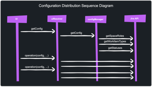

The app needs to use the Jira REST API to manage competition related data and API calls typically require passing the identifiers of Jira entities such as work item type IDs. To ensure the app implementation is both simple and efficient, each activity that the app performs starts with the creation of a configuration object by making several API calls and then this configuration object is used so that the IDs of all relevant configuration entities are known and can be immediately used in the subsequent API calls required by the activity.
A diagram illustrating the sequence of operations involved in distributing configuration information within the processing of an activity by an Atlassian Forge app.
Whilst this app doesn’t depend on environment variables, the same pattern could be used for apps that do since the configuration object is built in the back end (a Forge function invocation) which is where environment variables are accessible, and subsequently passed to the app front end where environment variables are otherwise not accessible.
Since the configuration data is passed to the front end and then back to the backend, it also contains a tamperCheckHash field which is a one way hash using a salt that it stored in an environment variable. Each time the backend receives a request containing the configuration object, it is validated using this has to ensure it has not been tampered with.
