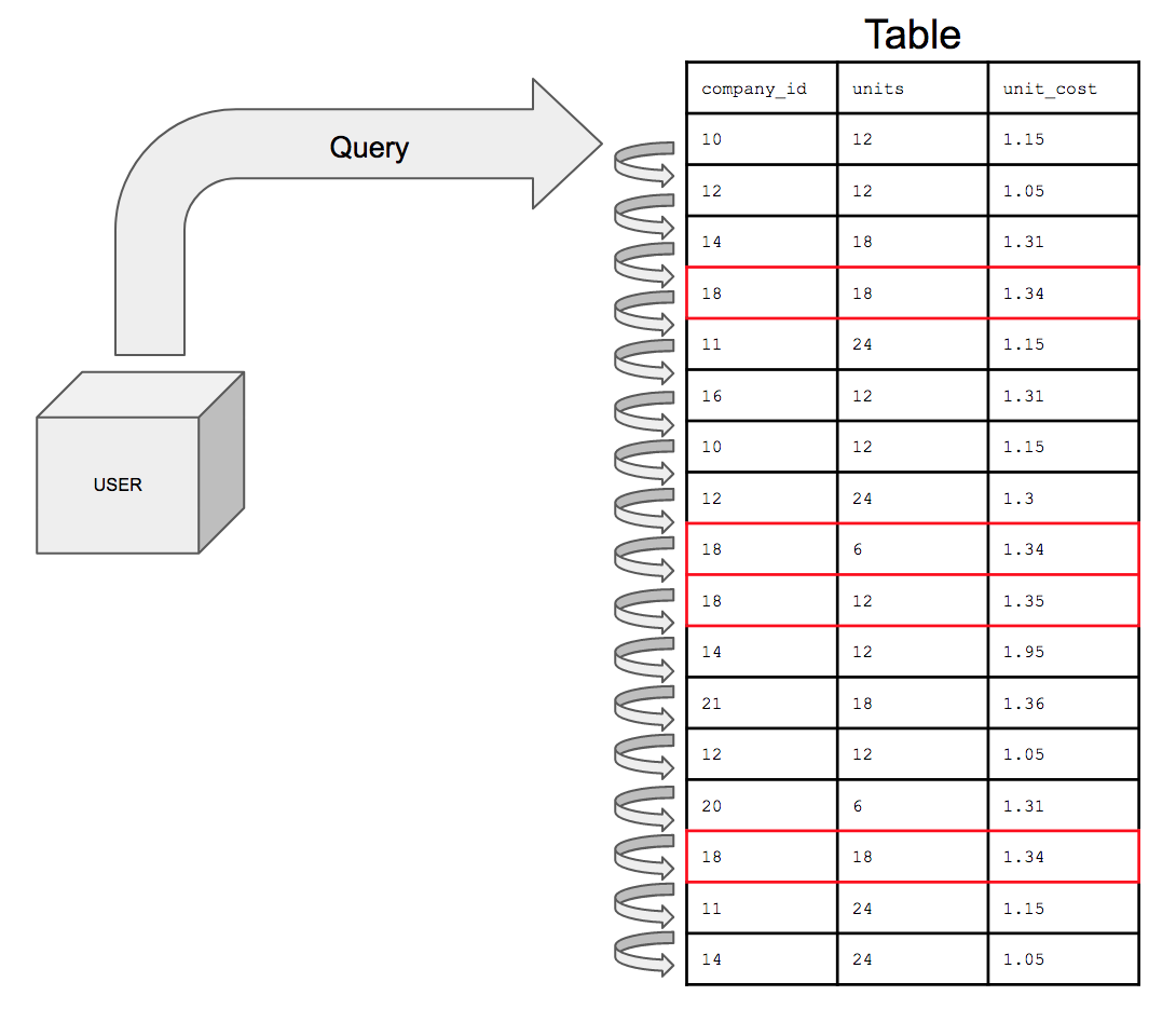

company_id = 18 The database would have to search through all 17 rows in the order they appear in the table, from top to bottom, one at a time. So to search for all of the potential instances of the company_id number 18, the database must look through the entire table for all appearances of 18 in the company_id column.
This will only get more and more time consuming as the size of the table increases. As the sophistication of the data increases, what could eventually happen is that a table with one billion rows is joined with another table with one billion rows; the query now has to search through twice the amount of rows costing twice the amount of time.
You can see how this becomes problematic in our ever data saturated world. Tables increase in size and searching increases in execution time.
Querying an unindexed table, if presented visually, would look like this:

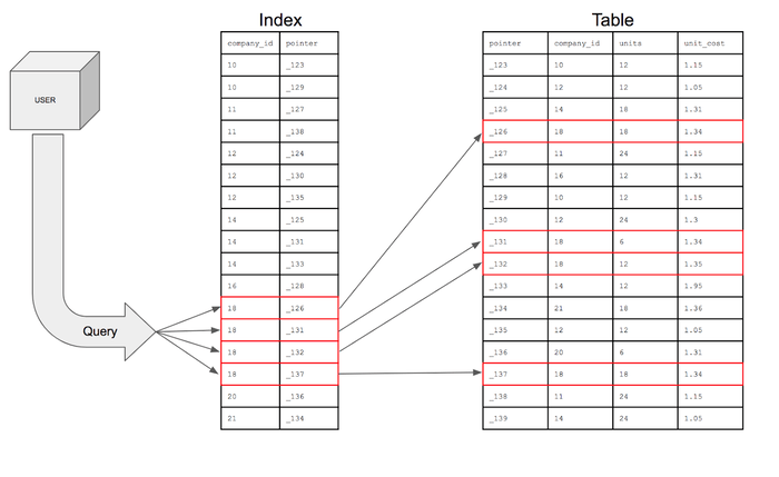

Database indexes will also store pointers which are simply reference information for the location of the additional information in memory. Basically the index holds the company_id and that particular row’s home address on the memory disk. The index will actually look like this:

With that index, the query can search for only the rows in the company_id column that have 18 and then using the pointer can go into the table to find the specific row where that pointer lives. The query can then go into the table to retrieve the fields for the columns requested for the rows that meet the conditions.
If the search were presented visually, it would look like this:
