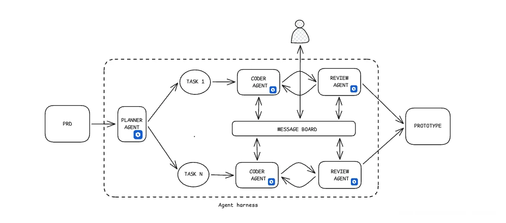

We knew we couldn’t run a single agent session to implement the whole PRD. The context window would be too small, and the agent would hallucinate halfway through. So we built a multi-agent orchestration:
  1. A planner agent to break down the PRD into work items
  2. A coder agent to do the work
  3. A separate reviewer agent to check it, with git plumbing
  4. A human in the loop to resolve agent conflicts
The agents needed a way to communicate on a shared message board to justify their actions, and any disagreement had to be escalated. We fed it the PRD and the acceptable mocking for real integrations, authentication, and persona derivation, then started the pipeline. The planner divided the PRD into work items, then the coder and reviewer went to work.
About 15 hours, ~250 agent sessions, 100+ review rejections, and 10+ escalations to a human later, a product was born. It wasn’t a wireframe or a mock. It was a running application with a real database that a user could actually use.

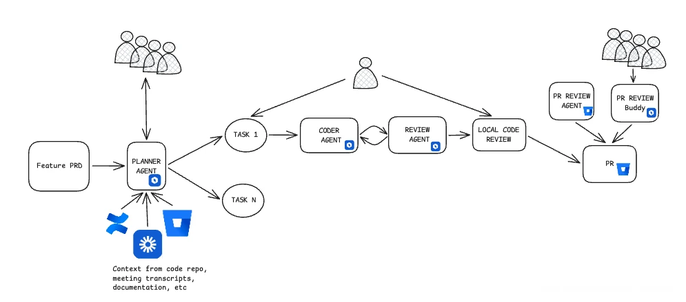

Iteration two: understand and plan first, then execute
Enterprise-grade differs from a vibe-coded product in that the person executing the spec isn’t the one shaping the product. Multiple stakeholders are. And an agent can’t stop mid-build to ask product, design, or compliance a question. So every decision that matters has to be settled up front and made explicit before the agent starts.
So before any agent touched the feature, we did the boring, traditional thing: real planning and grooming, up front, with no AI crutch. The team went through the feature, asked edge-case questions, and fully ingested the design.
Then we built an interactive planner with access to the codebase, the PRD, and other project artifacts. By design, it asked clarifying questions and surfaced gaps in the PRD. We conversed with it, and once every question was answered, we shaped the breakdown and refined the tickets before a line of code ran.
One problem remained: even when done right, the PRs were still large compared to traditional PRs. The PR review agent on Bitbucket had no issues reviewing the PR; however, we found it difficult to update our mental map of the code when the PR was large. So we built a PR review buddy. It has access to the codebase, the PRD, and the work item, and it can actually answer questions about the change. It doesn’t just flag gaps, a reviewer can use it to understand the code without pulling in the author for simple questions.
Simplified dev workflow
This was the turn! Because we now owned the domain before writing a line: Planning was faster, PR reviews were easier and execution accelerated!
