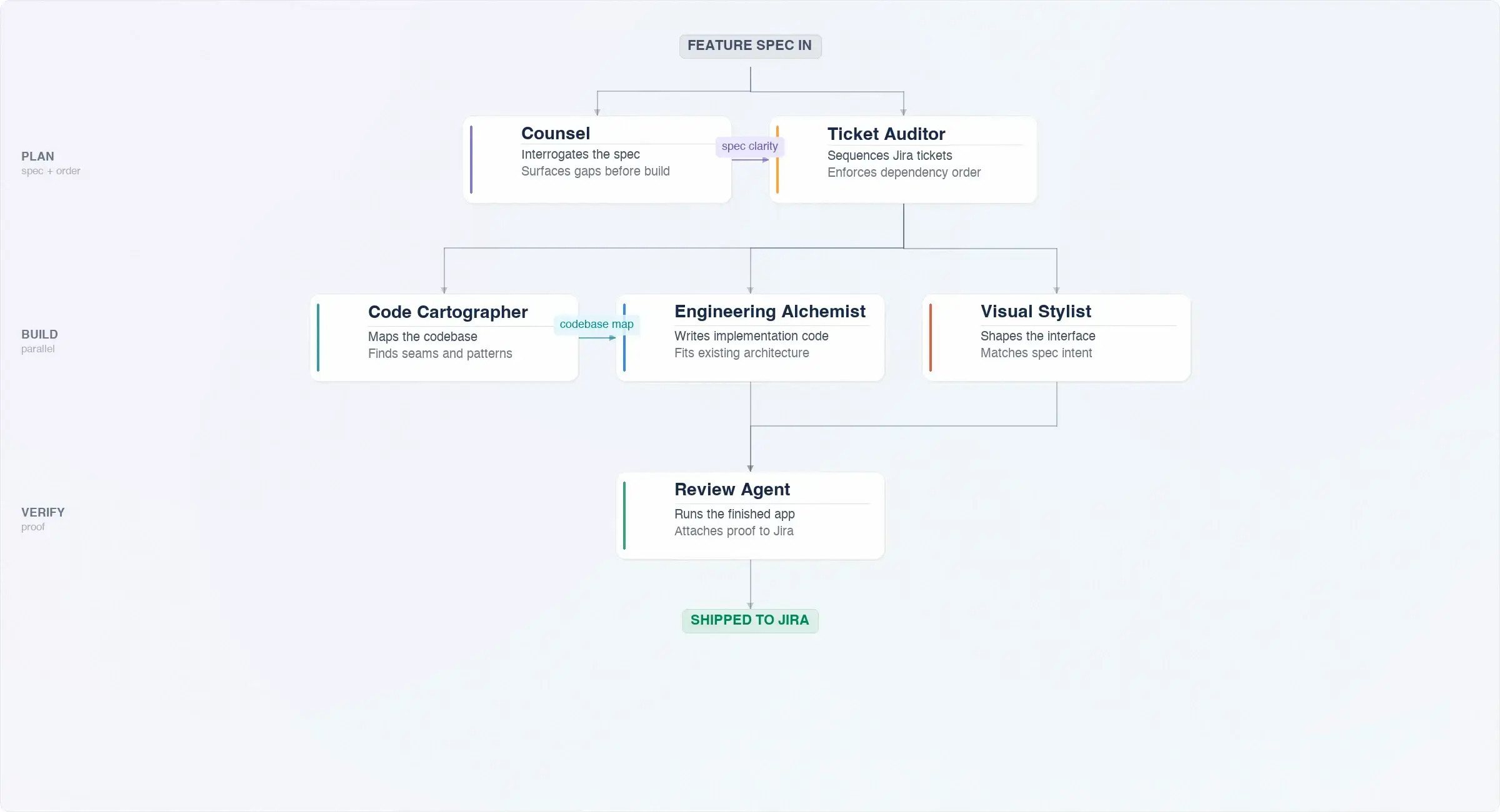

Think about how a strong team ships code. Nobody holds the whole project in their head. One person maps the codebase, another writes the feature, someone owns the look, someone checks the order so two changes do not collide. We designed our agentic system to work the same way. The problem is broken apart and handed to specialists, each with one job, small enough to fit into the context window with headroom to reason.
Our core agentic team
AgentWhat it owns
Code CartographerReads the codebase, maps the packages, finds the patterns and seams to build into
Engineering AlchemistAudits code architecture
Visual StylistShapes the interface so it matches the intent of the spec
Ticket AuditorKeeps the work in the right order so parallel changes never collide
Review AgentsCode quality reviews, Runs the finished app, video records the walkthrough, attaches the proof

List the teammates you wish you had, one job each, and make each a sub-agent the parent can call. Start with three: a Designer that owns product and UX intent, a Builder that writes the code, and a QA that verifies it against the spec. Pass the sub-agent only the ticket description and acceptance criteria. A fresh window and one job is what keeps it from drifting.
