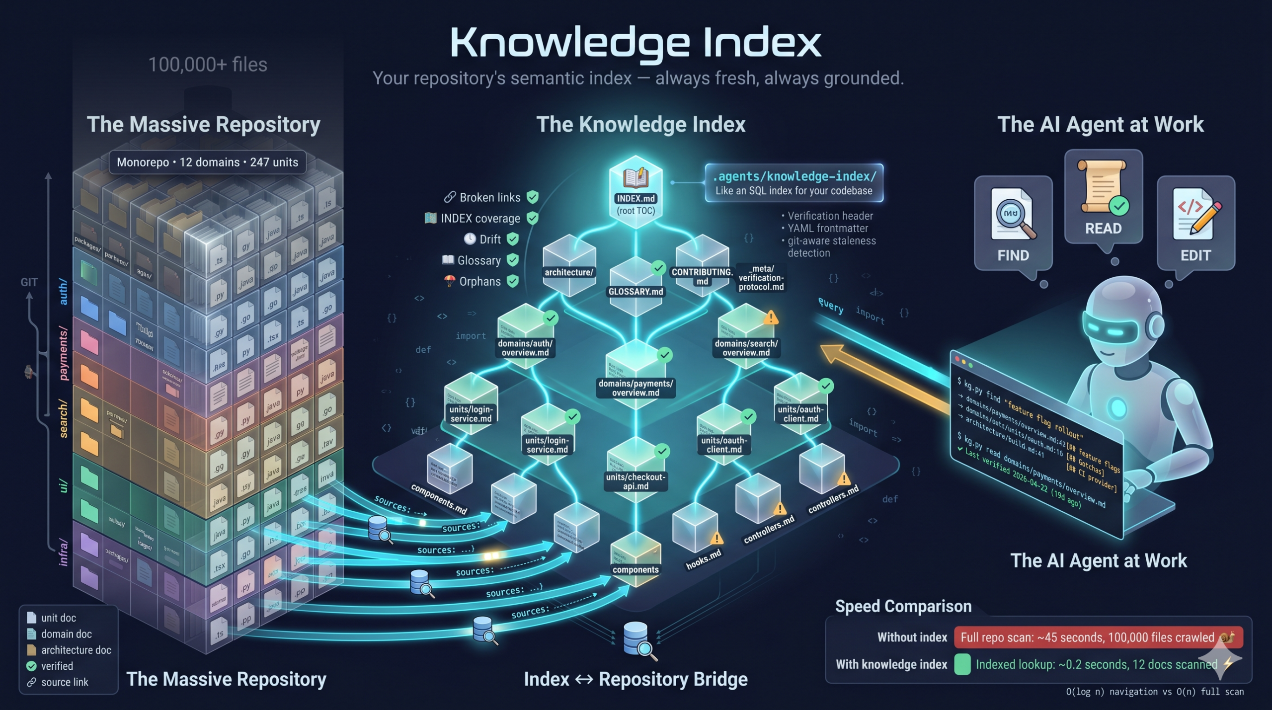

At a high level, Rovo Dev functions as an advanced autocomplete system – it automatically completes content, even entire files, by selecting the most contextually appropriate options based on its training data, prompt, and current context.
We create a knowledge index – a repository index, similar to a database index – instead of scanning the entire repository to find patterns for replication and autocomplete, an AI agent uses the knowledge index to shortcut the process.
Rovo Dev with the knowledge index outperforms the no-knowledge index agent. The index provides breadth of information about the standards in the repository without the need to explore thousands of files.
Testing shows lower token consumption and a higher adherence rate to repository guidelines and best practices.
To get the best results, instruct the AI agent to “copy” or “create something similar” by providing specific examples that enhance its knowledge index and ensure that autocomplete has relevant references to consult.
