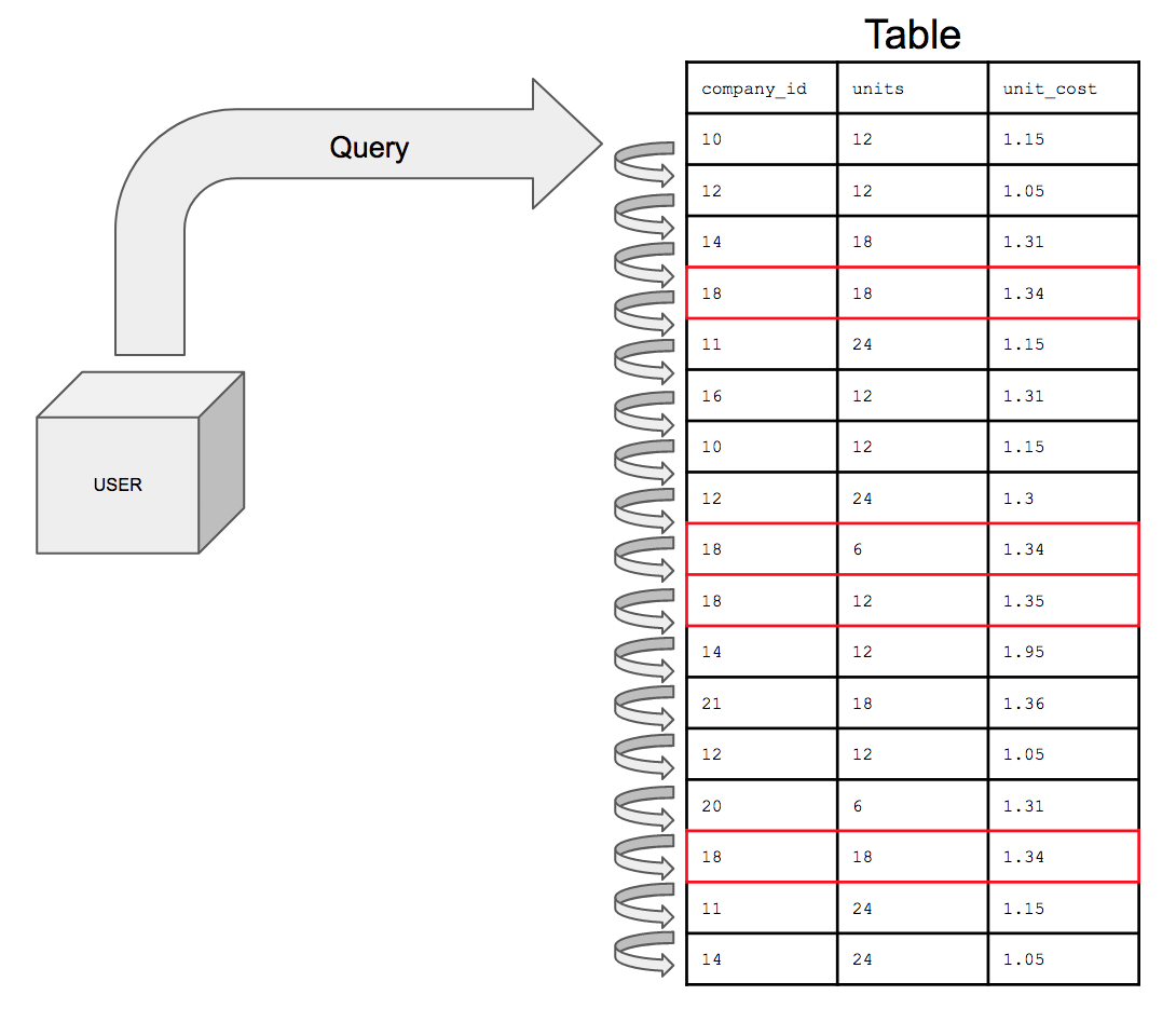

company_id = 18 The database would have to search through all 17 rows in the order they appear in the table, from top to bottom, one at a time. So to search for all of the potential instances of the company_id number 18, the database must look through the entire table for all appearances of 18 in the company_id column.
This will only get more and more time consuming as the size of the table increases. As the sophistication of the data increases, what could eventually happen is that a table with one billion rows is joined with another table with one billion rows; the query now has to search through twice the amount of rows costing twice the amount of time.

Querying an unindexed table, if presented visually, would look like this:

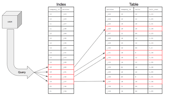

With that index, the query can search for only the rows in the company_id column that have 18 and then using the pointer can go into the table to find the specific row where that pointer lives. The query can then go into the table to retrieve the fields for the columns requested for the rows that meet the conditions.
If the search were presented visually, it would look like this:

- The query looks for the specific row in the index; the index refers to the pointer which will find the rest of the information.
- The index reduces the number of rows the query has to search through from 17 to 4.
