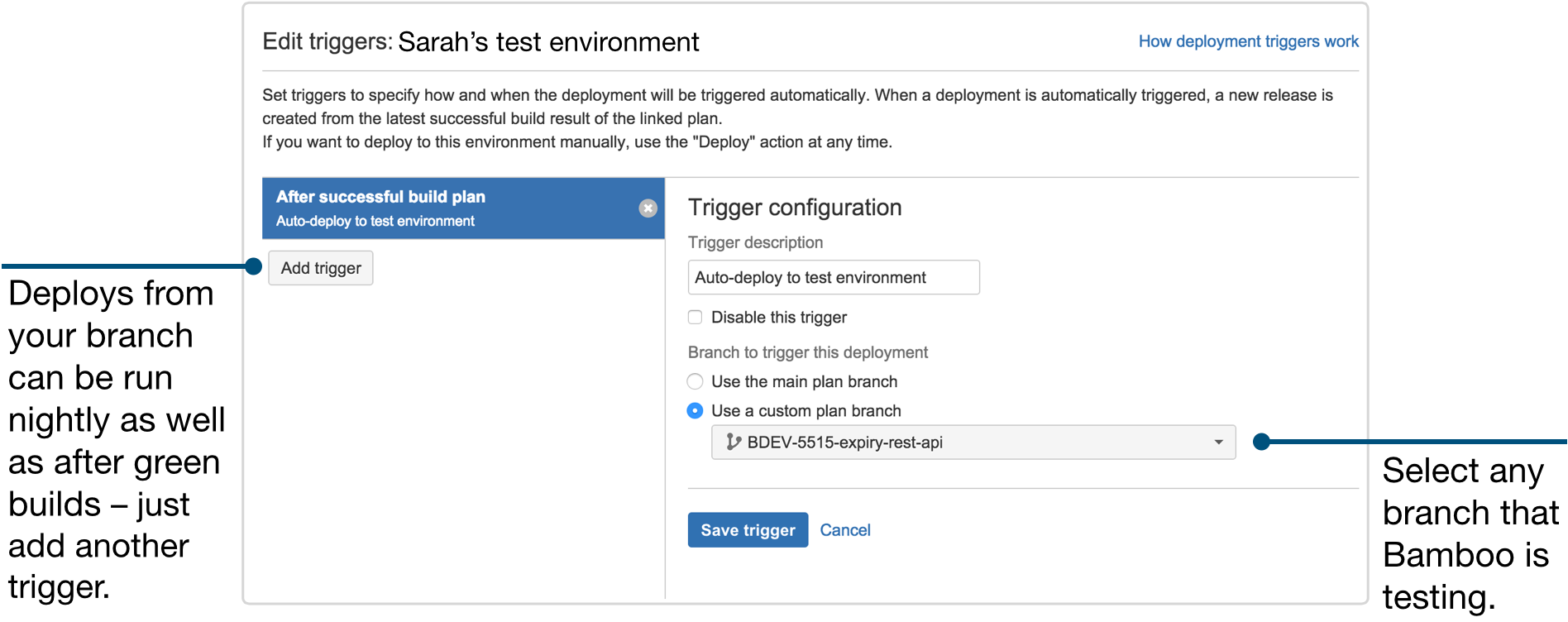

With branch deploys in Bamboo, you can configure the deployment trigger for any environment to automatically deploy the artifacts built on a given branch – either at scheduled intervals, or with each successful CI build of that branch. You can even use the two trigger types in combination.
Test environment screenshot
Let’s say you have a single performance testing environment that everyone shares. Throughout the day, deploy main there whenever it builds successfully – for most branch-loving teams, builds of main are usually the result of new work being merged in, so you’d want a gut-check on performance right away.
Then overnight when the repo is idle, schedule deploys from each developer’s branch at appropriate intervals so everyone gets performance feedback on their work at least once a day. (Deployment jobs in Bamboo can conclude with a script, Ant, or Maven task that kicks off performance tests.) All the while, developers can use automatic deployment triggers to send builds out to their individual test environments whenever their feature branch builds successfully.
To set this all up, you can either a create discrete deployment project in Bamboo for your dev branch, or associate your branch to an environment within a deployment project by customizing how deploys to the environment are triggered.
Create deployment project screenshot
Check out the Bamboo docs for step-by-step instructions on associating a deployment project with a branch and customizing deploy triggers.

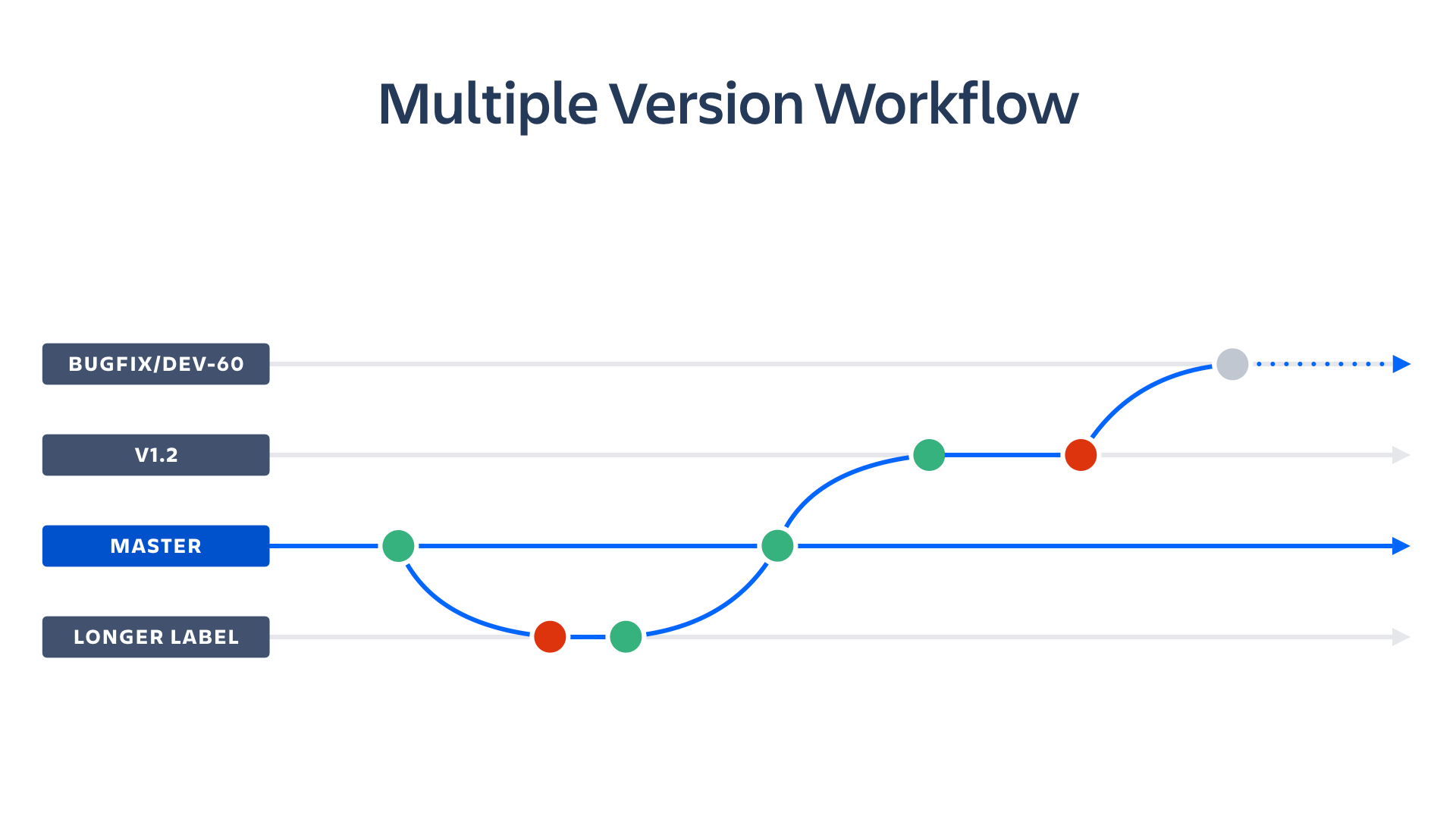

If you don’t live in the SaaS world, you probably have to support multiple versions of your software simultaneously, and occasionally ship critical fixes, back-port security updates, etc. This means maintaining stable version branches for a very long time – years, most likely. Builds from these branches are usually deployed to a common location, like a website or external repository, where customers can pull down updates to the versions they’re using.
Multiple version workflow screenshot
For these branches, the easiest way to turn builds into releases is with the create release button found on the build result screen for the build you're shipping. Sure, you can start at the all deployment projects screen as described above. But because you're zeroing in on a very specific build you want to ship – which isn't necessarily the most recent build on that branch – I think starting from the build result screen provides a little extra assurance that yes: this is the build I want to ship.
